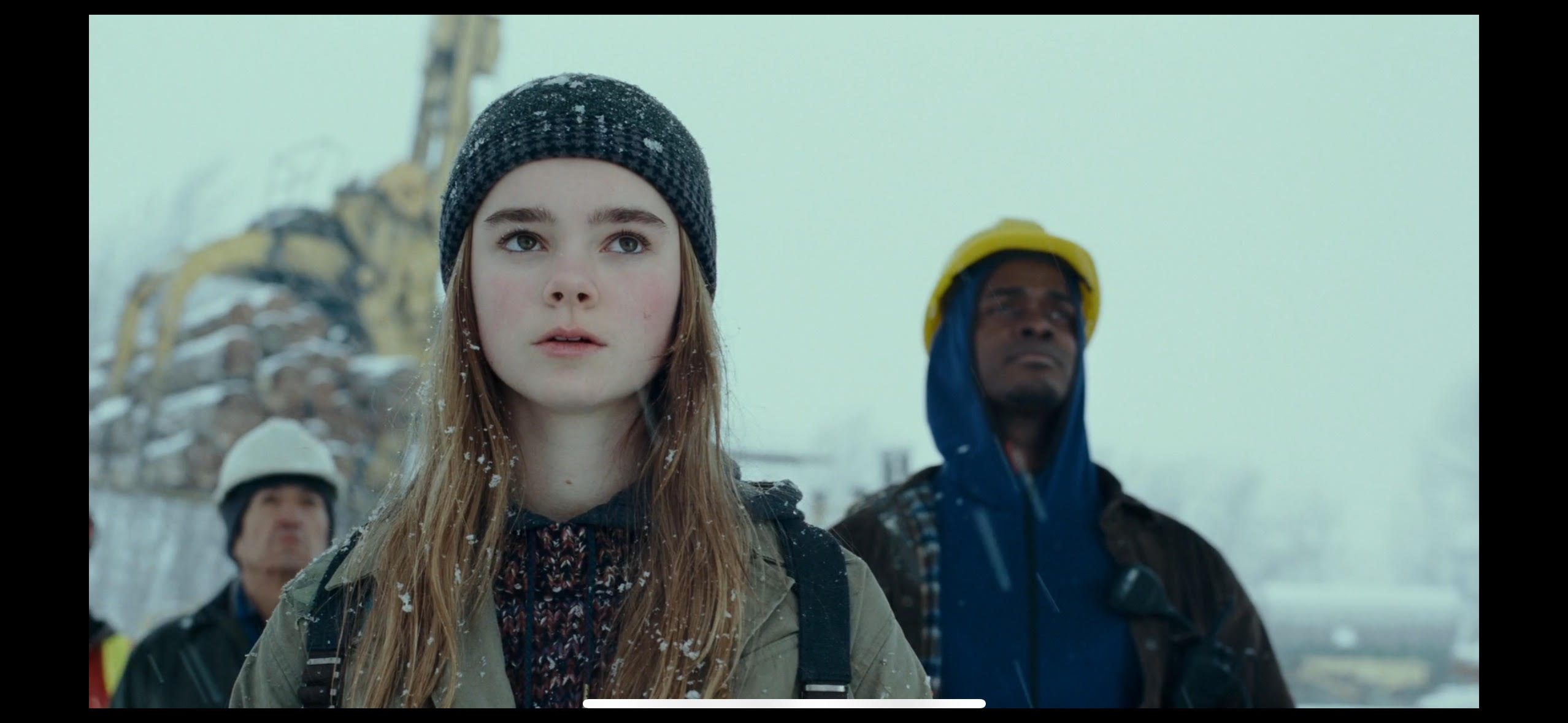

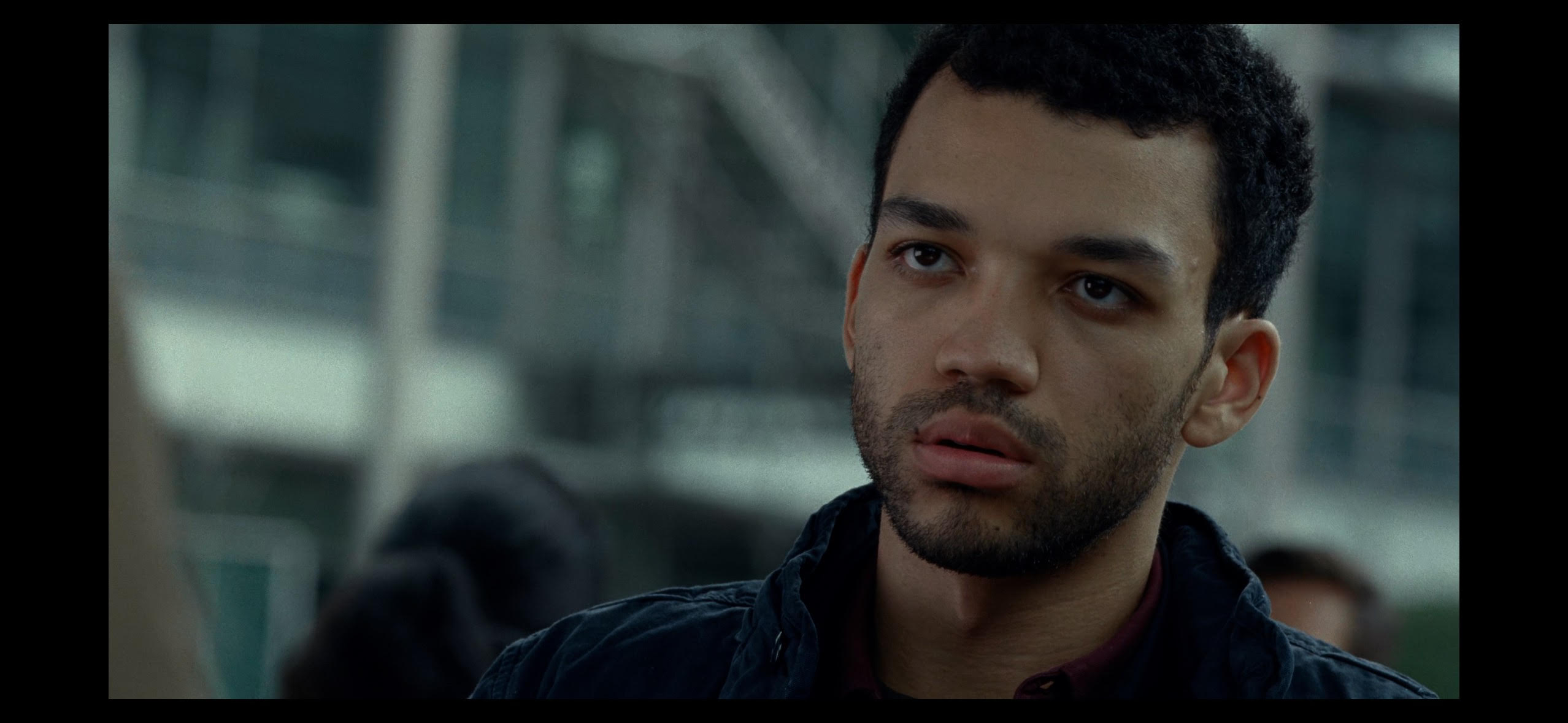

Hi, just got an iPhone 15 Pro and I noticed right away that only the “official” Apple TV app has the perfect scaling of videos without Dynamic Island intruding in the content…
Check here:
2.00:1 movie (no black bars in the file)
Apple TV app (wider frame)
Infuse Pro app (frame scaled down a little too much)
Can someone update Infuse optimizing the scaling just like the Apple TV app please?
Starting with iPhone 15 every model has the new “Dynamic Island” notch so it seems like a very important issue to fix…
Thanks for the help!

The scaling would also depend on the image ratio of the movie of course. There are some narrower ones too. What I find interesting is that video players treat both sides as if they had dynamic island and don’t use, at least for narrower movies, the obstacle-free bottom part much.
That’s why I took two screenshots from the same movie with the same aspect ratio: 2.00:1
They should be the same and they aren’t:
Infuse Active Area: 2202x1100
Apple TV Active Area: 2266x1130
