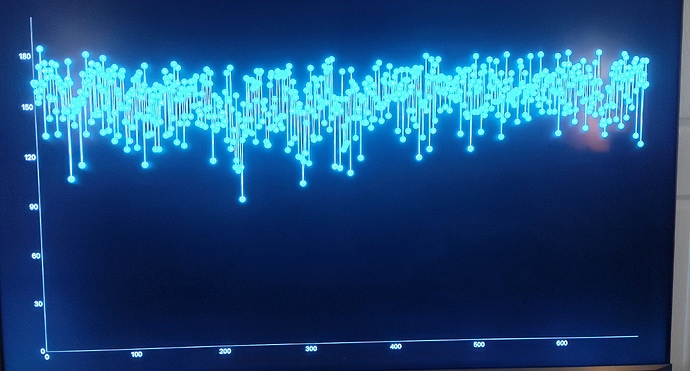

If you could run a speed test in Infuse and when finished post a screen cap of the graph? Sometimes that gives clues as to what’s going on.

Okay thanks. I’ve been reading about using a Nas and I don’t think it’s an option for me. My knowledge of PC’s and Mac is sketchy to say the least. And I don’t think it’s necessary. I never have more than about 9 or 10 files I want to view on the infuse Apple TV 4K app. I ran a speed test on my emby server for an entire 17 GB Dolby Vision file. I’ve attached the screenshot of the result. The speed averages about 150 MB and never drops below about 90. That should be more than enough to stream this movie on infuse without getting an intermittent black screen, yes?

Thanks for running that test :+1: Yup that should be adequate speed to stream videos. With the audio continuing and only the video dropping out momentarily I don’t think a speed issue would be to blame.
