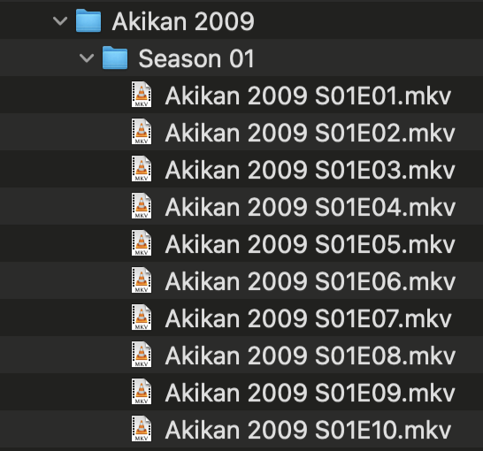

A screen cap of the directories and file names for a show that isn’t working may help.

If you remove the exclamation point and add the year Infuse will find it without a problem. Sometimes characters like exclamation points will throw things off.
I tested this naming structure and Infuse found it right away.
