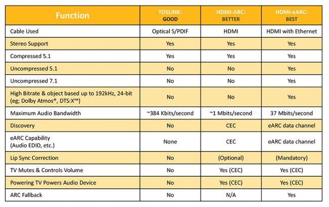

Check the attachement
eARC is required for PCM audio above 5.1. It’s part of the HDMI 2.1 spec however some HDMI 2.0 receivers are getting the update. You MIGHT get an update for your TV if it’s relatively new and it’s a top of the line flagship model. I have a 2 year old LG OLED and it hasn’t and probably won’t get eARC support. It’s probably best to contact your TV manufacturer as they will be able to give you better answer.
