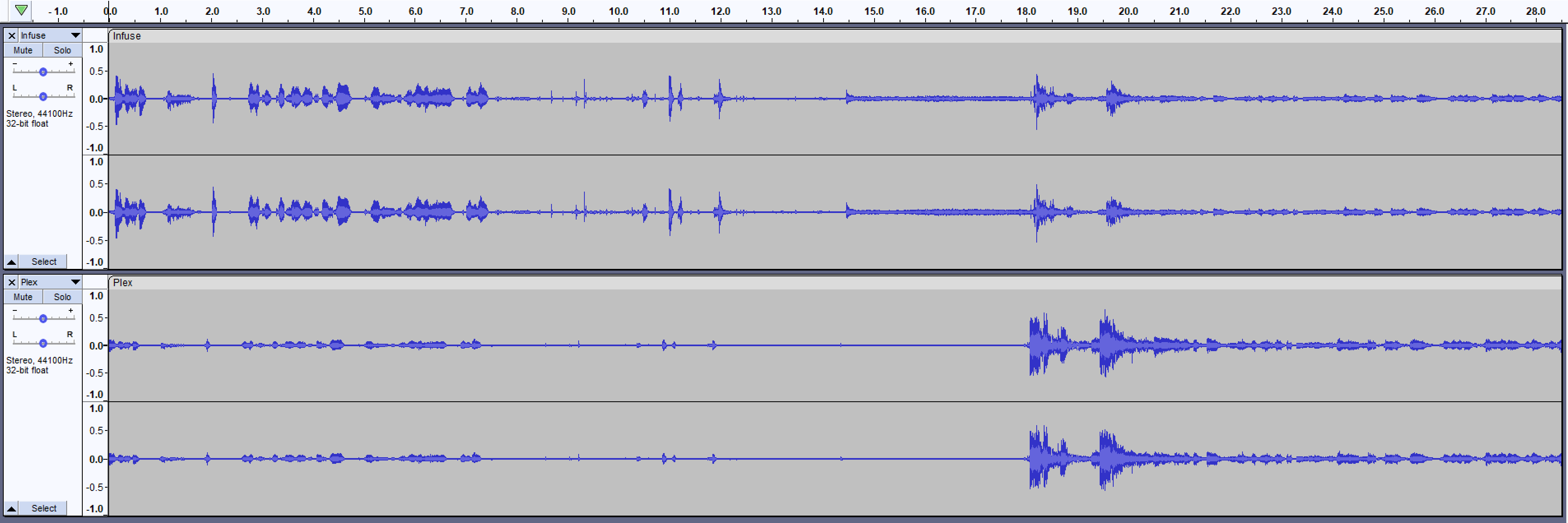

I made 2 sample audio recording files captured a Sony digital record line in. No change was made by me in volume output via remote or any other source.
Clip is from the 2013 movie, The Last Stand.
Infuse: LINK
(at 35 secs, i pause it, then resume, to show how the volume increases back to normal)
Plex: LINK
Here is looking at the audio waveform in Audacity.
Both:
Notice how for sure, Infuse (top) is showing higher levels, then Plex.
At 18secs is the the loud bang (gun shot followed by another), and it dips with Infuse.
Below is zoomed in Infuse levels, just before the bang, it dips, and where the vertical line is, that is where i pause it for a sec, then resume, and you can see the volume level go back to normal.
Below is zoomed in of the loud bang sound to compare both files, top 2 is Infuse, bottom 2 is Plex.
The difference is quite clear.
Notice how the second bang is lower level than the first. followed by the lower dialog, with Infuse.
Plex does a FAR better job with the audio.
You can hear both gun shots clear, and all the background sounds, ricochet, and later dialog stays clear, and at normal volume.
