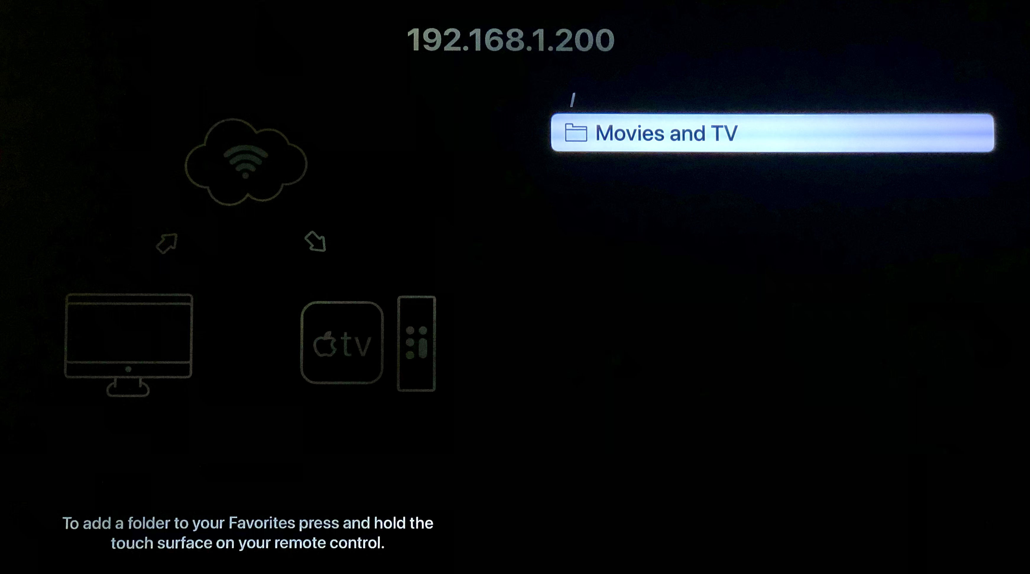

The thing that works for me, however, is the recycle bins are attached to each share on the NAS — not each folder. So my NAS share is “Movies and TV” — and this share has subfolders including “Movies”, “TV”, and a recycle bin.
The two folders I’ve shared to Infuse are “Movies” and “TV” — not their parent folder “Movies and TV”.
You’ll only see the recycle bin (on older versions of Infuse) if you connect Infuse to the top-level folder of the NAS Share itself.
Don’t add this:
Add these (the items with the :star:s):
Any videos deleted from either the “Movies” or “TV” folders on my NAS, or any of their subfolders, gets moved across (or up and across) to the recycle bin for the “Movies and TV” share. As that bin is outside the “Movies” and “TV” folders, Infuse will never see them — but will notice the next time it “scan(s) for changes” that the videos were removed from the shared folders, and thus remove the deleted items from the library. :+1:t3:
