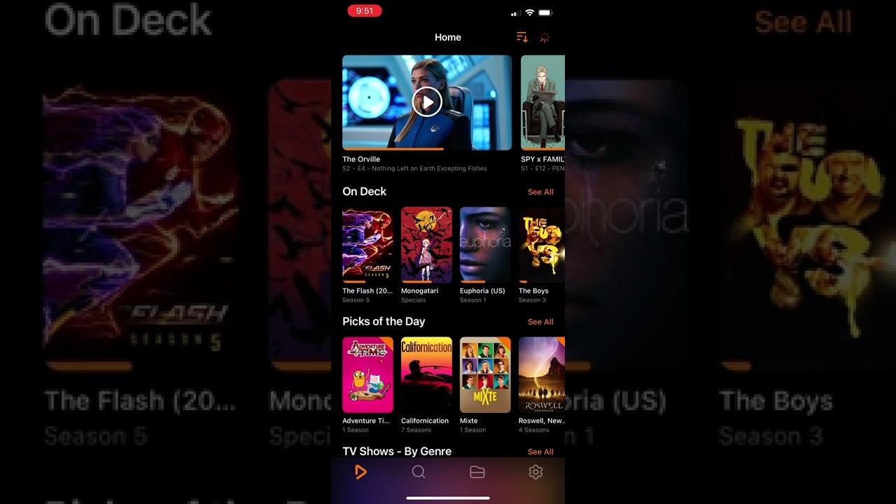

Why does it take this long for infuse to load?
On the top, we are waiting for it to find out what I’ve watched and where I am in those shows.
Under that, it took even longer to load on deck.
After a painfully long time, you’ll notice it’s still loading something on the top right.

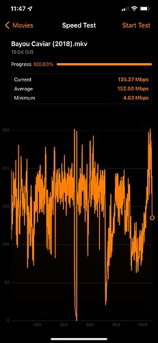

Once it loads could you do a speed test in Infuse and post the results?
I don’t see a speed test option within the app.

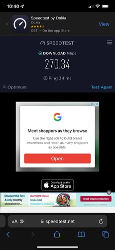

However my mobile speed is fine
Settings > Add Files > Saved Shares > Tap Edit for share with videos on it > Scroll down to Speed Test > Select a larger video file and run the speed test. Also a screen cap of the graph available with those results may help.
Is this share located on a LAN or is it a cloud service?
google drive->rclone->mergerfs->jellyfin

Yeah bro my Jellyfin is up to date. Performs the same way if I’m doing google drive direct, plex, or Jellyfin. I’m also 100% using the latest infuse. Even tried beta
I think it’s worth mentioning this only happens on ios. on mac connected to the same connection, it loads fine
