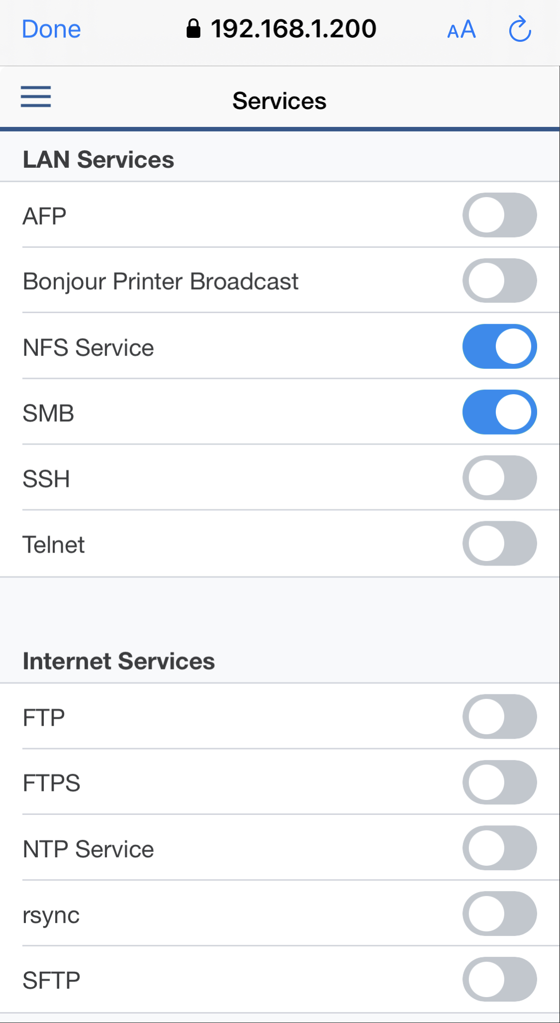

Yeah, honestly, the only two things I ever had to do to set up my Synology NAS to work with Infuse on all my Apple Devices was to make sure a single toggle button on my Synology’s settings page was in the on position (either one of the two selected items currently shown as enabled in the following image); and to enter my Synology’s local IP address (as permanently assigned per its MAC address by my router) into the first Apple device I got around to setting up (iCloud later automagically synced the server’s IP details to all its compatriots):
