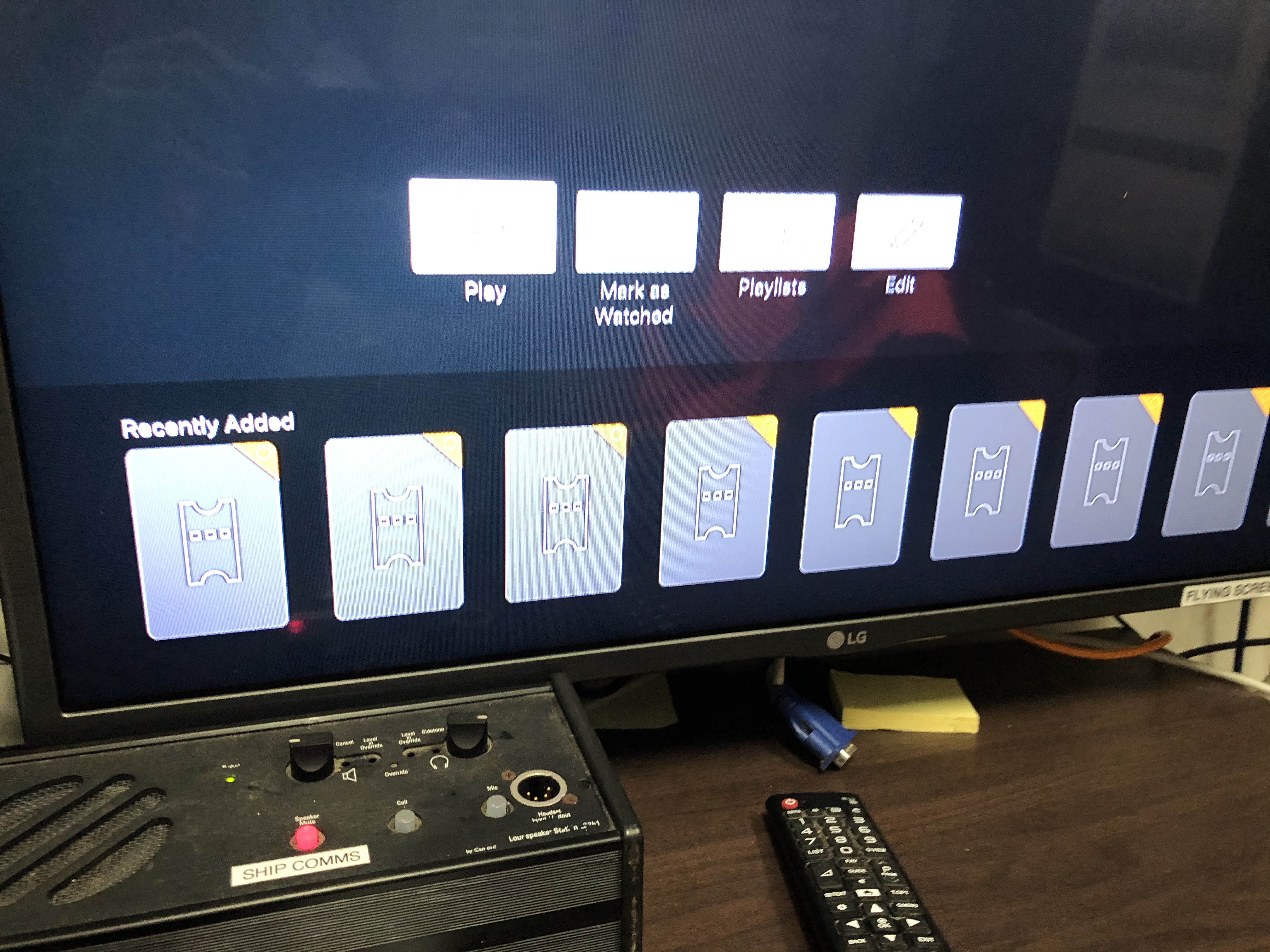

I have a problem with infuse pro6 on my apple tv.

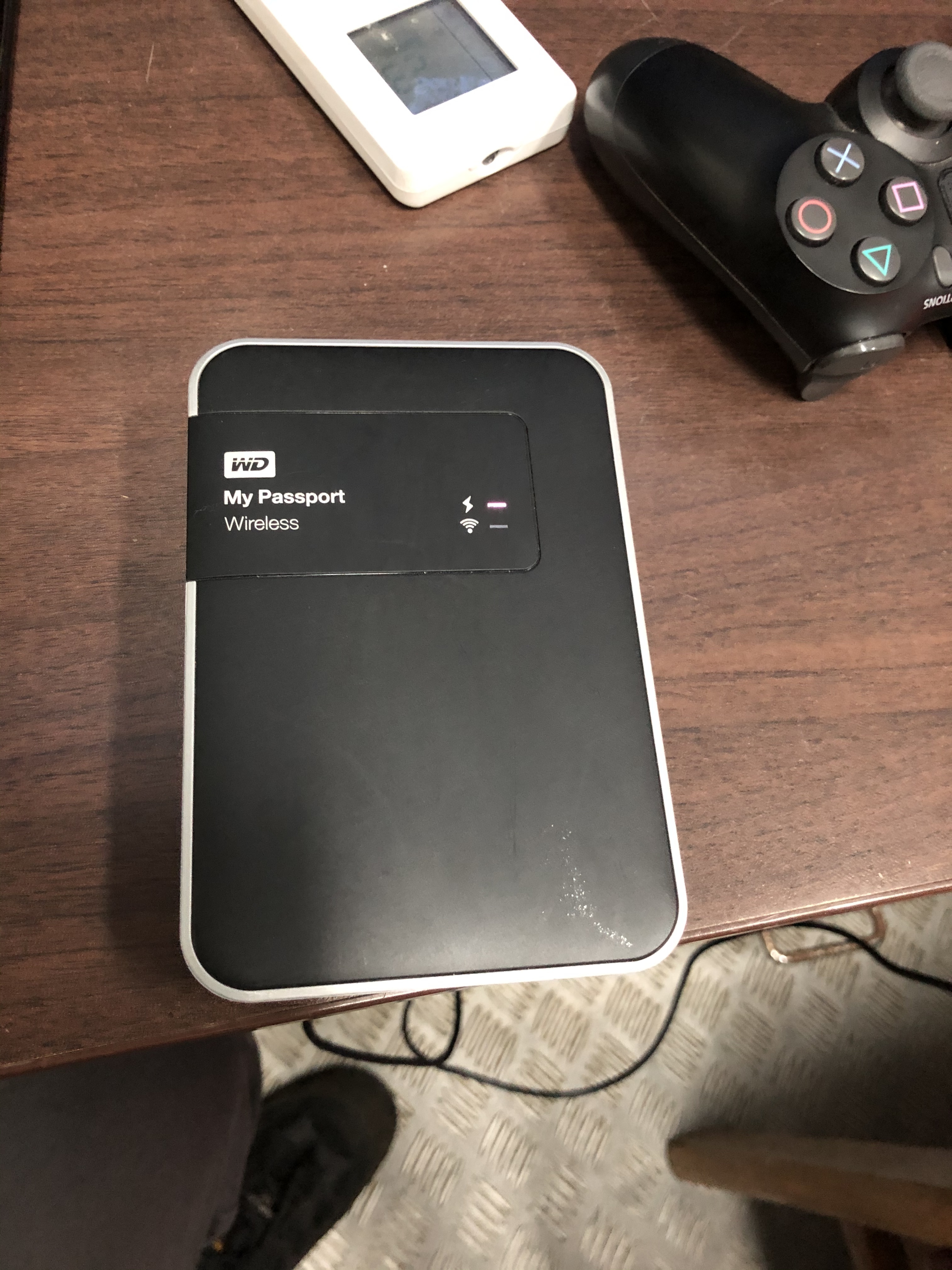

I tried to share videos from my wireless hard drive(WD My passport)
I can share the video files but it won’t play just buffering
Knowing it’s not freeze or halted i can exit any time also it happen with any kind ext.
any support guthanks in advance

Are you trying to connect directly to the WD drive wireless or did you connect your WD drive to your local WiFi network first?

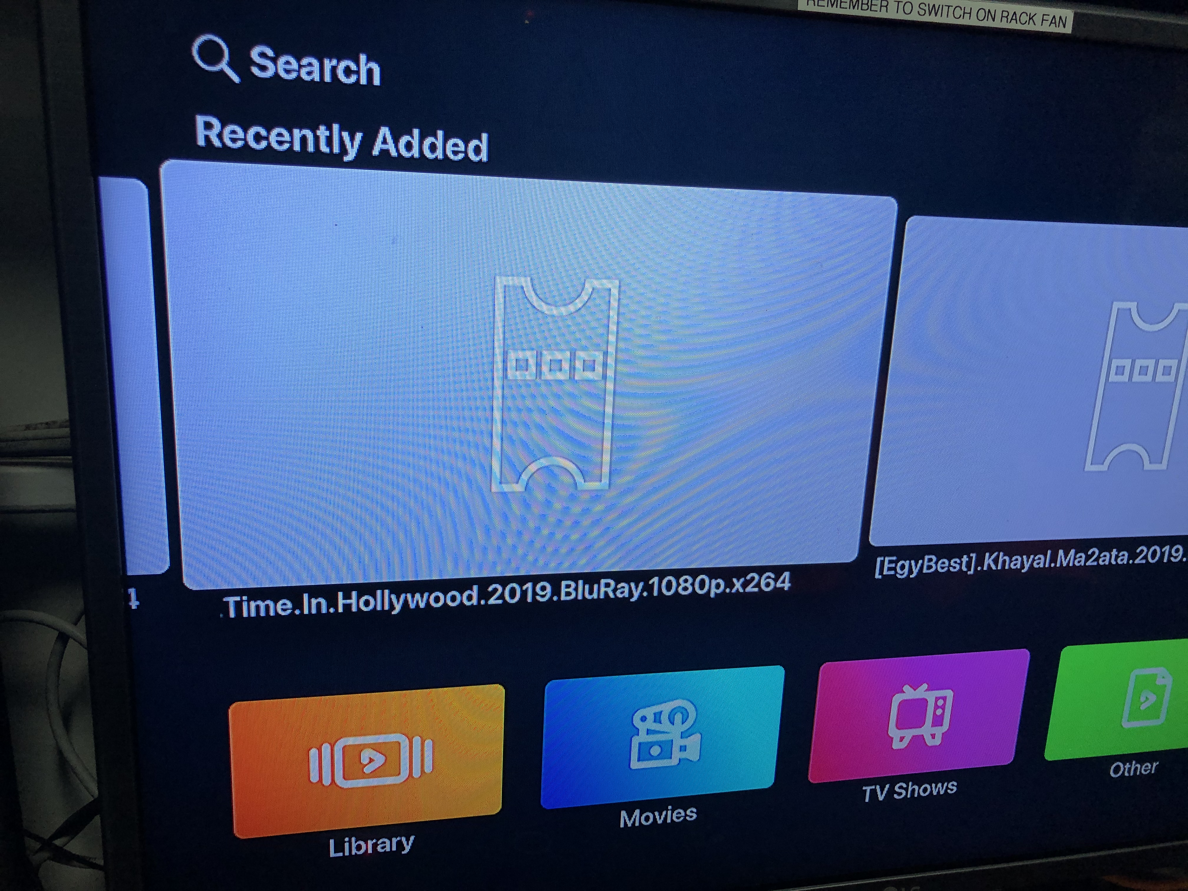

Yes am connecting directly to My passport wireless and it’s affecting all the video file.
I got just the video file showing but no picture on them and when i choose play it just keep on buffering

What is the exact filename you are trying to watch
What is the resolution (1080p as per your screenshot?)
Whats the filesize?
