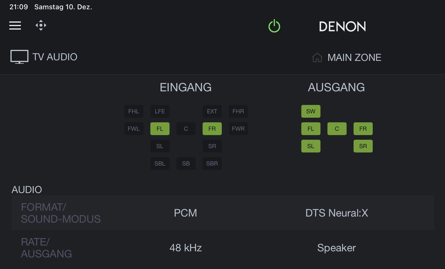

This is the input signal shown by the Denon app with a MKV video with AC3 2.0 audio played by Infuse (Eingang = input, Ausgang = output, Audio setting ATV DD 5.1 (change format)):

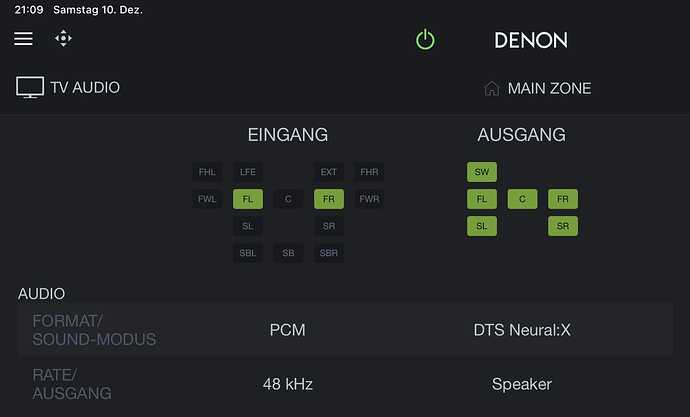

And this is the input signal with the same video played by MrMc or Plex app (same Audio setting ATV DD 5.1 (change format)):
The problem is probably that the 2.0 sound is also sent to multichannel LPCM and some devices do not handle this, so it will be Dolby Digital 5.1, which is a mistake, because it should be treated as native sound, so if the sound is DD 2.0, then DD 2.0 should be the output sound too. It would be great if this could be fixed because it is one of the best players out there. I really like it, but this sound problem is sometimes very annoying.
