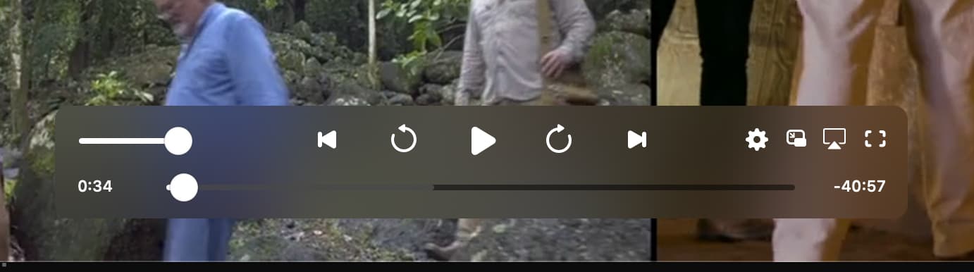

And also cache ahead works fine, look at the progress bar:
You can see half of the video content is already loaded, and it loaded it pretty fast really :D, like 2-3 seconds :smiley:

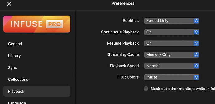

Hi, can you try changing cache to Memory Only?
Also, are you using the latest 7.4.4?
