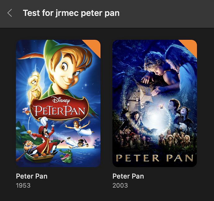

This is working for me when I test here.
Even using a filename like this gives me the correct 2003 match.
Peter Pan 1953 {imdb-tt0316396}.mkv
Maybe a temporary glitch in the Matrix? :man_shrugging:
