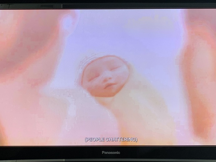

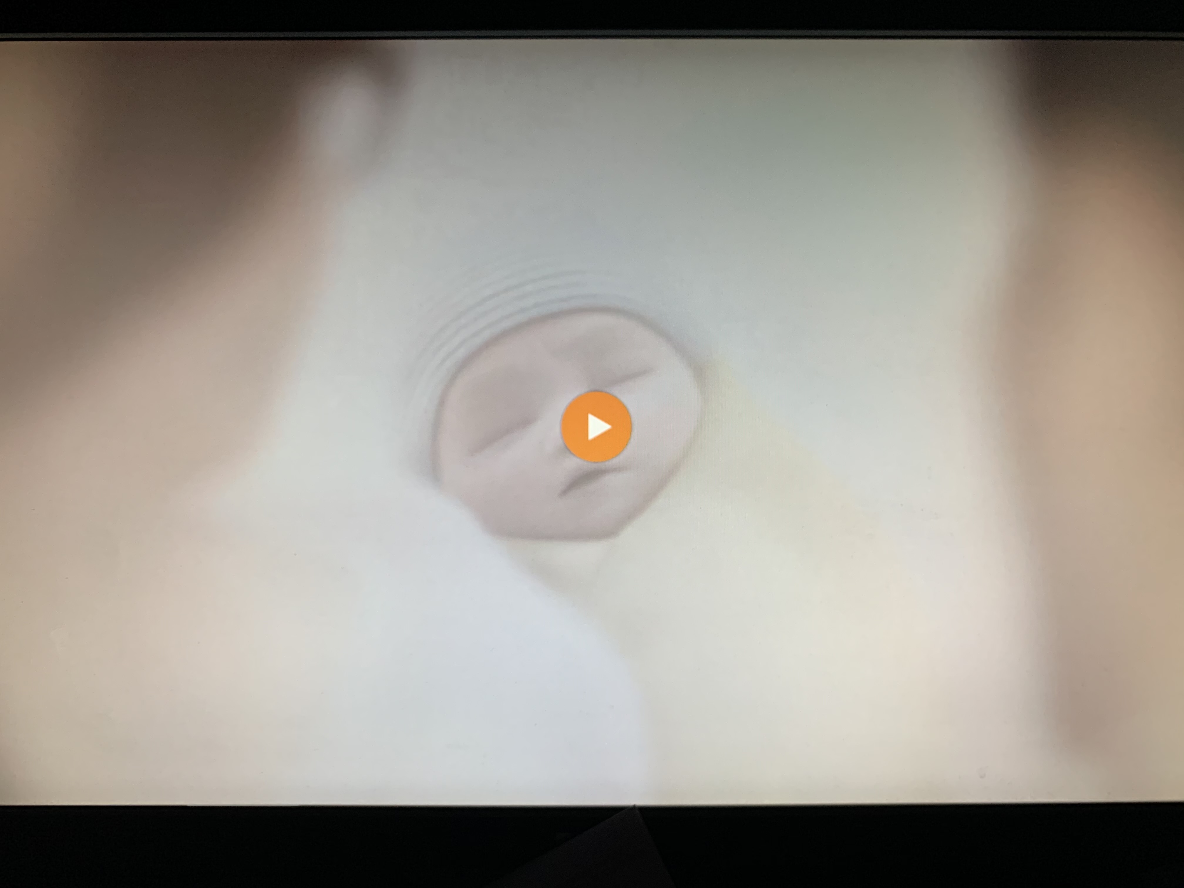

On some movies, mostly anmiation where there are a lot of the same colors on the picture, the quality is really, but really bad. Lots of compression artefacts. When looking at the PMS status, I see that the movie is playing directly with no transcoding. When I look at the same scene on my computer in VLC (or on the web UI of Plex), the picture is perfect.
You can see attached the same scene from my PC and from the TV.

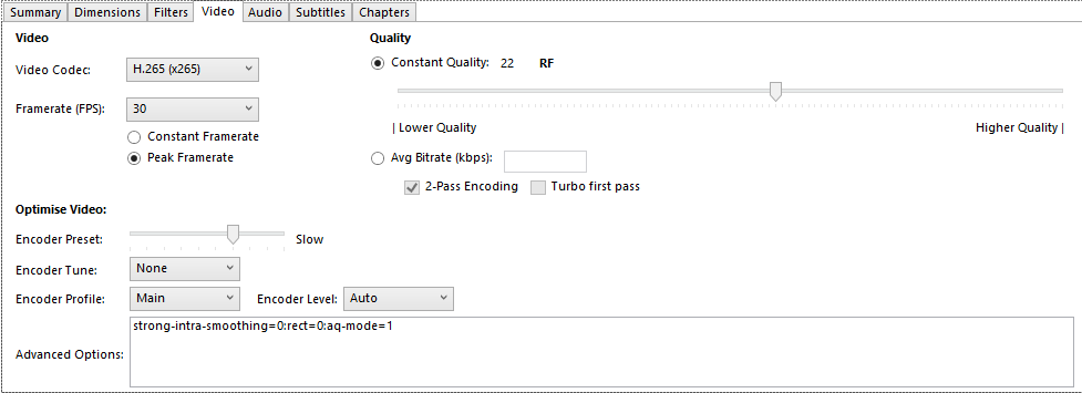

can you post a screenshot of your Handbrake Video settings screen?
The recommended settings for an x264 video encoding (which is the default on Handbrake) is RF (Rate Factor) 18 to 22 for Standard Definition. For higher definitions, you can play with the Quality bar, 19 to 23 for High Definition, RF 20 to 24 for Full High Definition and 22 to 28 for Ultra High Definition.
And you might consider to update Handbrake. Your version is outdated since 12/2018
Do you need to be able to play the files using the original ATV player? If not, you might want to consider the MKV H.265 1080p30 preset
I tried to lower rf factor, and I got the same results.
Attached. It’s the default for apple hevc.
