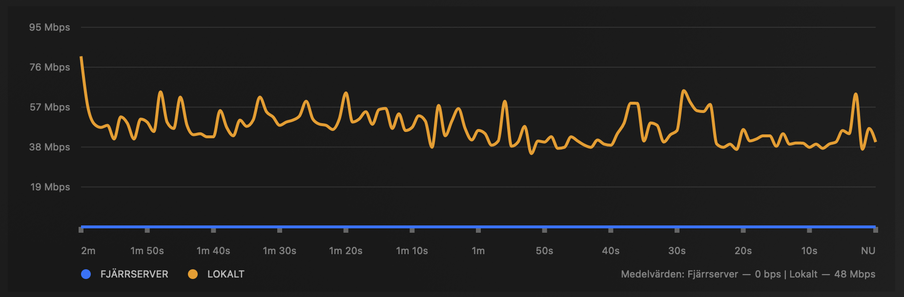

Could you please elaborate on this? What does this average speed indicate for this specific file when running a speed test? Are you saying that the speed needs to be much more higher then 40-60 mbps since the file is in 65 mbps?

Looking at the graph you provided there appears to be a network speed issue with all of the drops to the sub 20Mbps.
When playing videos in Infuse, the quality will always match that of the original video - without any transcoding. This is a little different than the Plex app which may adjust quality on the fly to get around low bandwidth issues like this if they appear.
When running a speed test in Infuse it will test the actual network pipeline from the source to the Infuse app. If you are seeing less than ideal speeds here then it means there is a bottleneck somewhere in the chain.

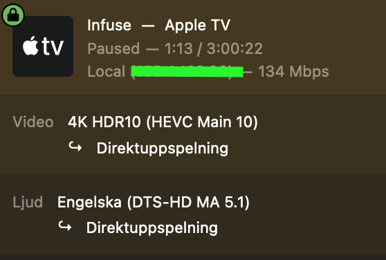

Here’s also a picture from my friend’s server. Don’t know if that helps. My friend has also mentioned that it’s weird that it shows that the movie is streamed locally which, according to him, isn’t correct. But he assumes it is because I’m registered as a local admin of the Plex server. Could that affect the speed?
Another picture from his Plex server. Here it does say “Local” and it’s mentioned that both audio/video is Direct Play:
