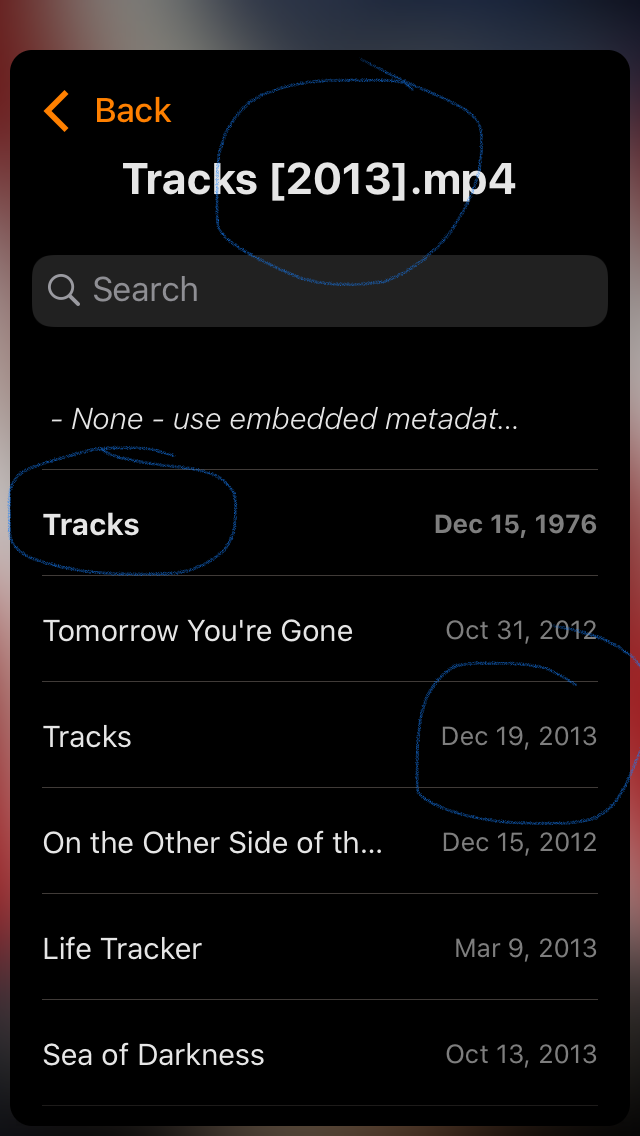

I named a file Tracks [2013].mp4 specifically so that Infuse would select the metadata for the 2013 release of that film not the version from the 70s. But Infuse is selecting the 70s one by default instead of the 2013 film even though I specifically put the year of the film in the file name.
Is the year in the file name supposed to do anything or does Infuse ignore it?

This actually looks like a quirk with the search results provided by TMDb. Even when Infuse sends the year, the top result is the 1976 release, which Infuse uses.
The same thing can be seen when searching on their site.
If you want, you can kind of hack it to avoid having to manually edit the movie by using the Bulgarian title: Пътища [2013].mp4
https://www.themoviedb.org/search?query=Пътища%20y%3A2013&language=en-US

This shows up because there was an Italian re-release of the movie in 2013. I’ve had this same issue with another movie and contacted them about it. They said there is nothing to do except use a different filter for search. Instead of just year, you can use theatrical release or primary year or something. Don’t remember exact syntax. But that would need to be something that Infuse would have to change. And who knows what the fallout would be for changing that?? Some testing would have to be done on a lot of movies.
