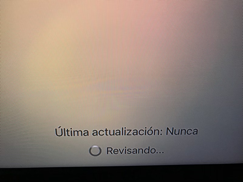

again to happened!!!
I only have installed in the APPLETV4 infuse and plex.
I’ve turned it on and I’ve lost the entire database.
NEVER puts!!!
Why is this happening?
It’s disappointing I never step in with infuse 4 ever.
And I have the entire base with covers in local and takes hours Escaneándole is very slow I have 4500 movies and 256 series.
Had the icons changed for library and other favorites and have been deleted this as newly installed.
You’ve only kept your shared folders.
