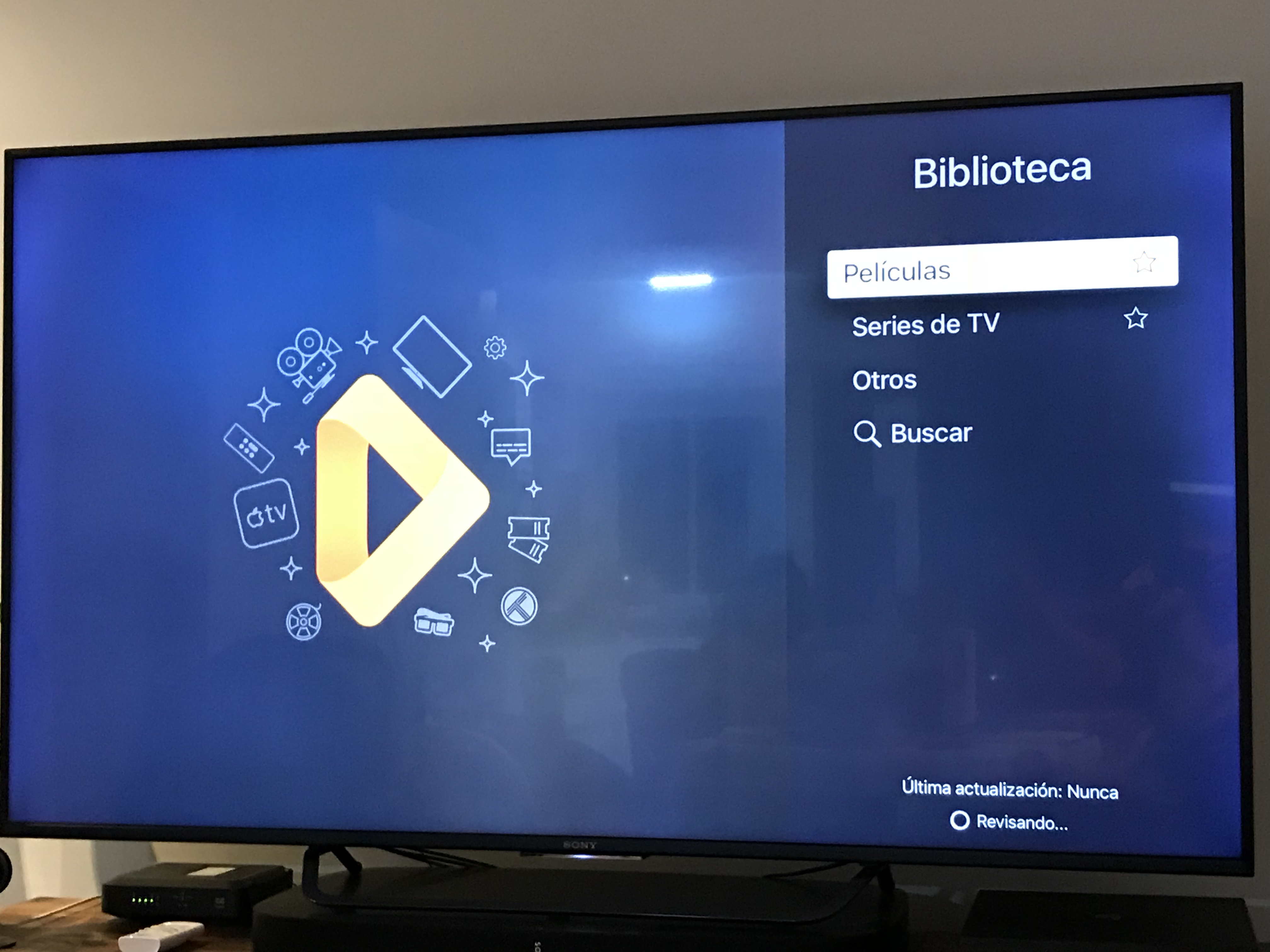

Hi James still happening on infuse 5.5.5 … today just open infuse and no data (check the last update “NEVER” legend), i didn’t update apps nothing from yesterday =(

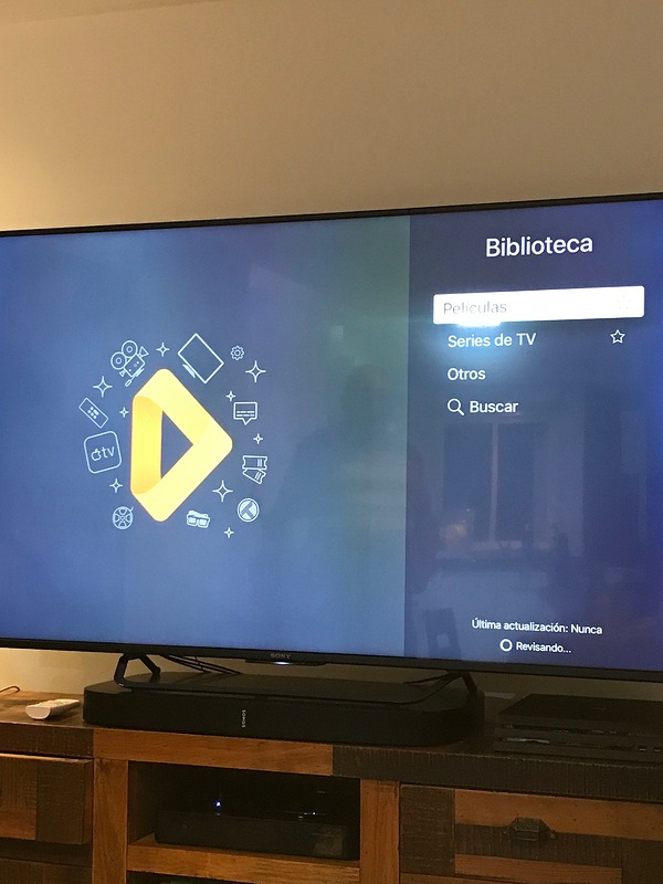

Hi James, and it happened again, it’s very disappointing to have to wait for the whole library to reinsert itself again, I have a big film catalog and it takes hours to do this again.
Here the new report and few images:

5.6.1 includes a number of optimizations so Infuse will take up less space, but the root issue here is that your Apple TV is running out of space which is causing it to remove info cached by Infuse and other apps.
Infuse is pretty efficient with the space it uses, but some Apple TV apps can be surprisingly large (for example, a certain fireplace app takes up over 1GB of space).
It might not be a bad idea to look at the apps you have installed, and remove any you don’t find yourself using. Otherwise, investing in a 64GB model might not be a bad idea.

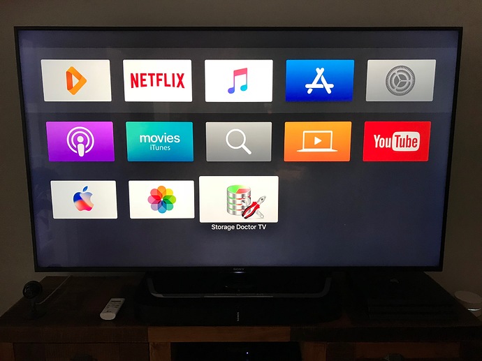

Hi James, I understand the problem is the way ATV4 manages disk space, but it seems weird since I only use my ATV4 for Infuse and very much less frequently Netflix.
I think an Infuse update (5.6.1) shouldn’t take much disk space and I think I it is not the cause of disk filling.
Please see the storage usage details image after reindexing the library (I also leave the list of installed applications).

It’s hard to say what the actual threshold is, as this is undocumented and wholly determined by Apple. If you’re only using Infuse and Netflix it would be interesting to find out what is taking up all that storage. Is that app able to give you a breakdown of how much each app is using?
As a frame of reference, Infuse libraries are generally under 1 GB. Anything over 1GB generally means you have a lot of files (see here: Metadata Storage is Adding Up - #13 by eyealar). I don’t think we’ve seen a library over 2GB (especially now with 5.6.1), but I suppose it’s possible.
Hi, there is no way I can see details of the space used by each app, I just can see only total values. I have 1325 movies and 1292 series as seen in the image, they can add some GB, but it would be interesting to know what is taking the storage since as you could see I have almost nothing installed.
