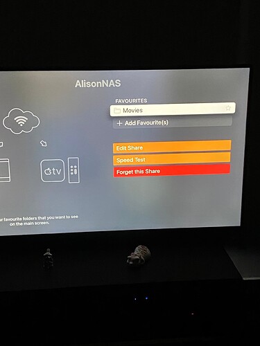

Infuse is duplicating my library
On the library settings page on the left side there’s a message that tells what current action is going on like Fetching, Syncing, etc. (in your above pic it shows "Fetching metadata for AlisonNAS (29 of 18313) ) Have you started Infuse and gone right to that page and then monitor that message until it’s done the fetching ( this could take a while) and done the iCloud sync until it shows "Last Updated… " message for a minute or two?
The reason for the wait after the "Last Updated… " message is that the iCloud sync often will happen a few times after the fetch with a brief period between syncs that show the Last Updated message.
Another question, your library page shows some 5K+ TV show episodes but on your NAS you only show a “Movies” folder. Do you have your TV shows in that “Movies” folder too?
What all is inside that “Movies” directory on the NAS?

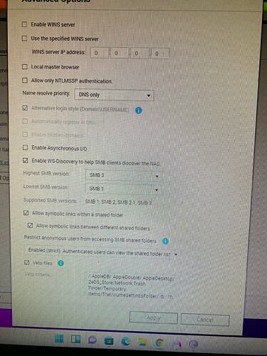

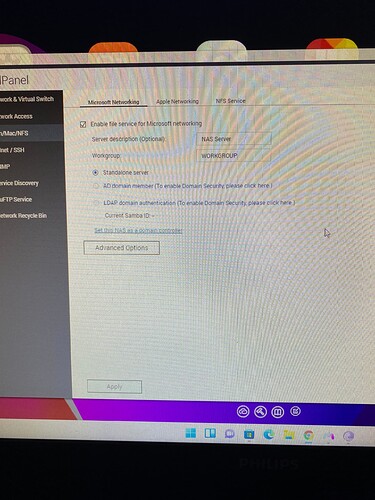

I took these photos of my NAS settings. I’m not sure if there is anything in these settings that can be impacting. I am very tech savvy, but some of these settings I don’t fully understand yet, so I thought just best to send the photos for your viewing. Thanks. !

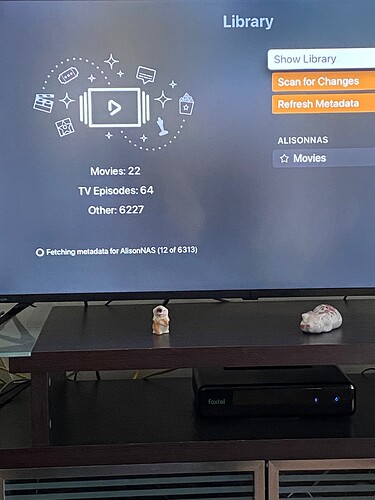

I have reconnected my backup HDD that has the entire copy of all the movies and series that is on my NAS. So far it appears to be working fine, it has correctly found the right amount of movies and episodes. In the photo I’ll share, you’ll see only around 6500 total. In the earlier pictures, it shows over 18000, which is definitely incorrect. I am guessing that the issue of duplicates is causing the incorrect count. But as to the cause, I am at a loss. I have also submitted a ticket to infuse support and to QNAP support, I am hoping we can find the resolution with everyone helping with even just the smallest of ideas.
