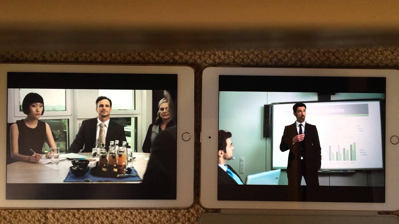

I have confirmed the HUGE improvement in HEVC h.265 video playback. I compared Infuse 4 and Infuse 3.6.2 side-by-side with a 1080p HEVC file. It was smooth with Infuse 4 and completely unusable with Infuse 3.6.2. I made a video here:
Yay! :smiley:
