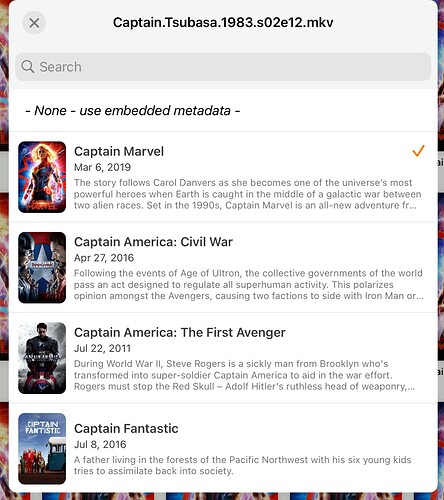

Despite being named in the correct style “SXXEXX” infuse still can’t recognize the animation series Captain Tsubasa
When trying to edit the metadata manually, the app doesn’t even recognize that it’s a tv series and all it’s showing is movies result.

Still digging but I did feel like this was a name I’d heard before and it seems that there is some strangeness going on with this. Here’s a prior problem and what worked for it.
Not saying this is the end solution but could you try just Tsubasa 1983 S02E02 and see if that works? I’m not where I can try it right now.
Well its a mystery to me for sure. Removing the “Captain” and space from the front of Tsubasa 1983 S02E02 fixed it. It pulled the correct metadata for Captain Tsubasa season 2 episode 2 without having to do and edit metadata.
