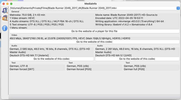

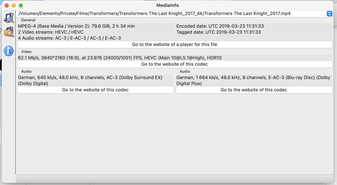

What profiles are those? Can you explain, how I can recognize it by myself?
Those are all HDR10. Basically the only Dolby vision that will play 100% is the DV that comes from a webrip.
