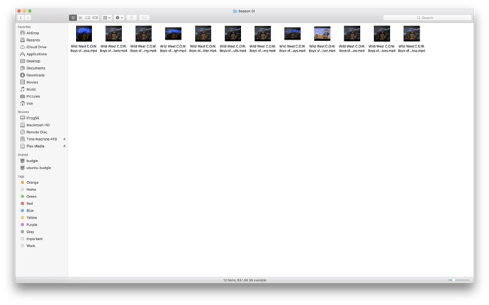

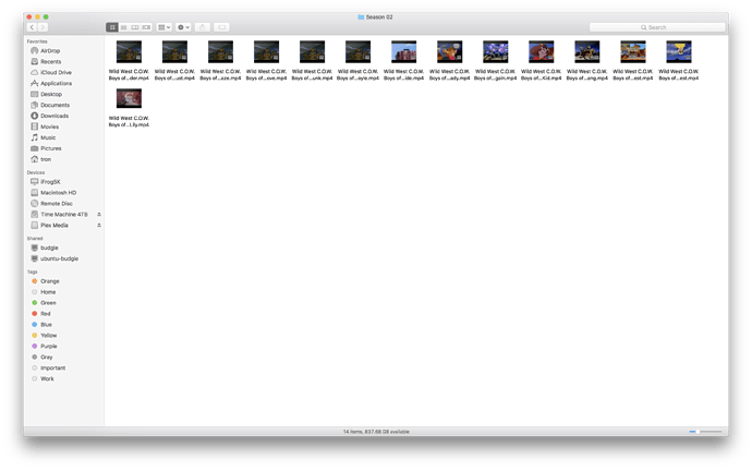

Here are some screen shots of the appropriate files and folders. Keep in mind that InFuse is the only item that chokes, All other media solutions identify the show and episodes correctly as per the above link;
I just noticed in icon view the names don’t show the full name, so if you want me to retake in list view let me know, if this isn’t enough to go by.
Your last two screen shots don’t show the full file name since the desktop truncates the name with three dots “…” to make it fit under the icon.

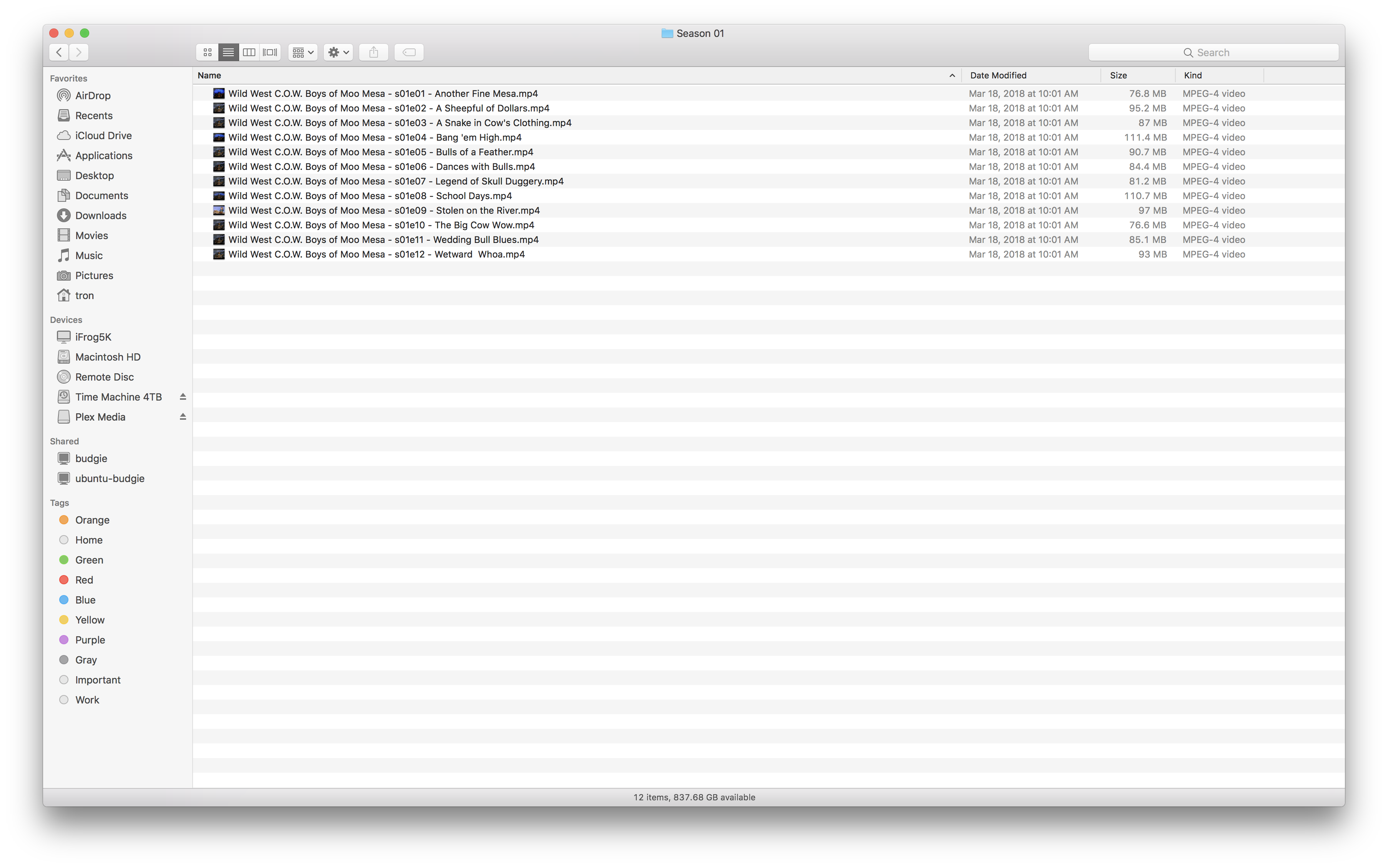

Could you switch to “List View” and make sure the window is wide enough to see the entire name? Or just copy and paste one of the file names in your post.
Thanks!
Already done, uploading season 1, and 2 list now.

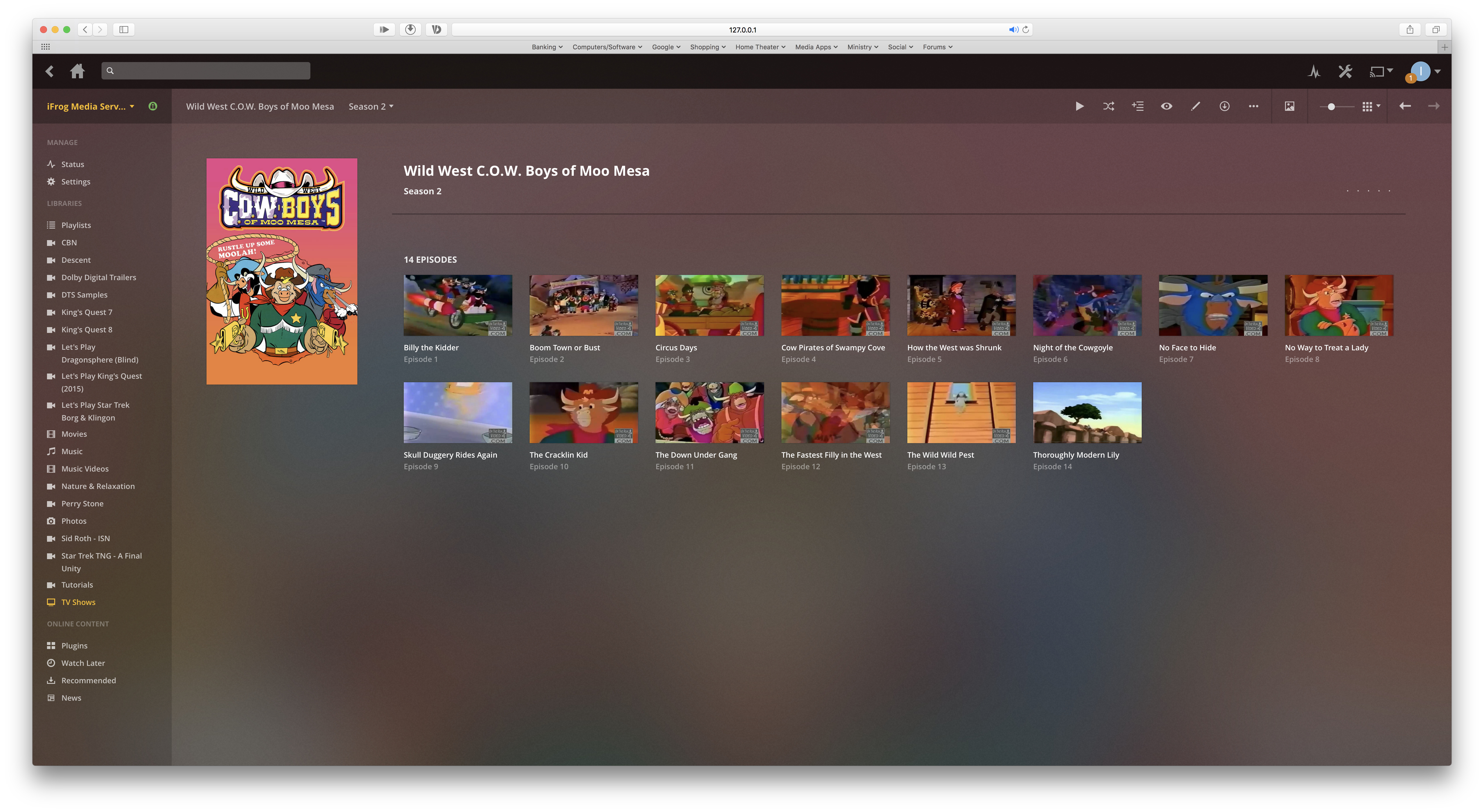

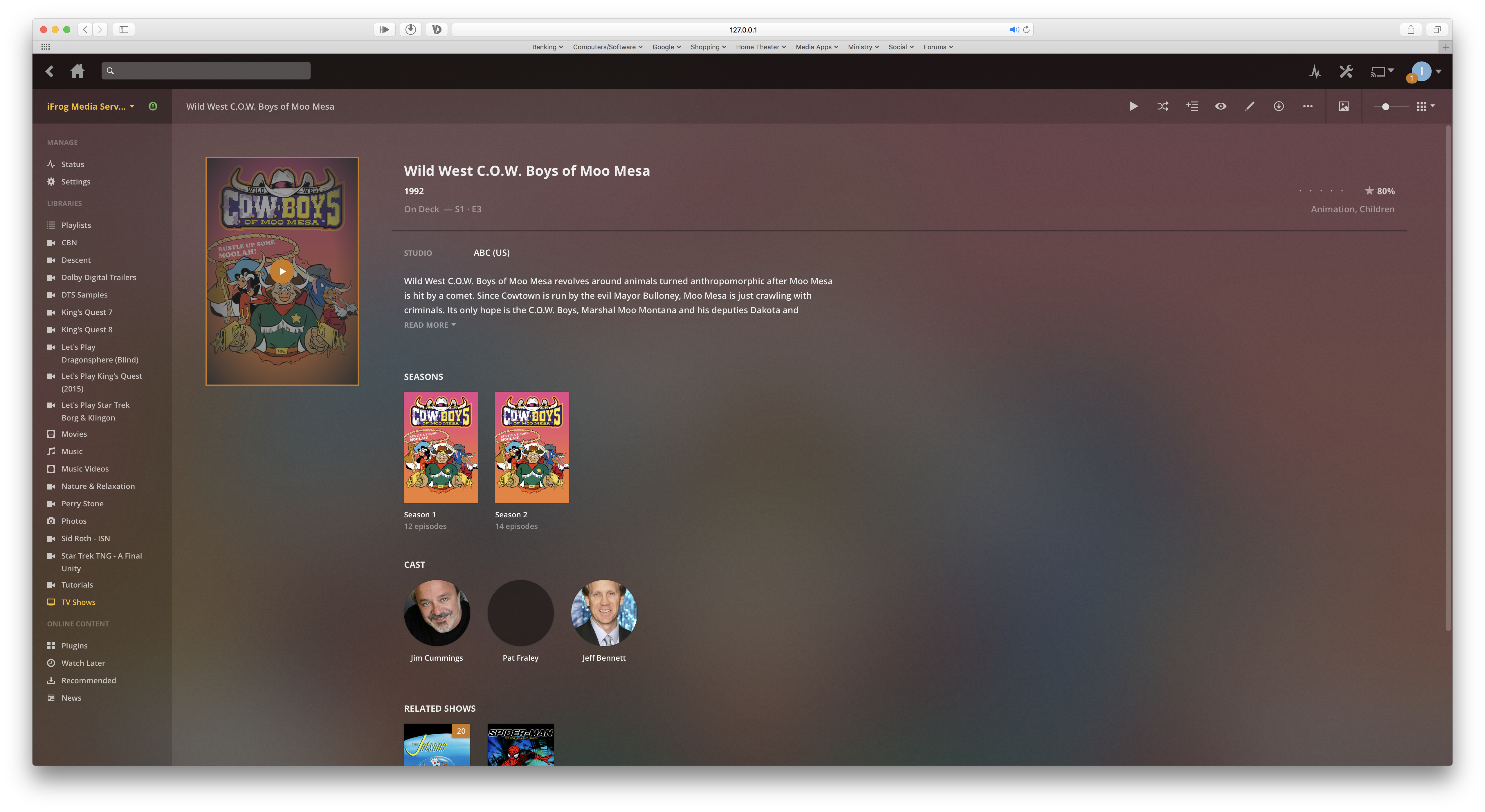

here are a couple screenshots from Plex to confirm the show is recognized the way I have it setup
Got it.
If you remove the periods after the letters “C” “O” and “W” from both the file names and the main folder it automatically pulls the correct metadata and artwork.
I just tried it and it pulled everything correctly.
This is a similar issue to the Marvel Agents of Shield series where there’s a dot after every letter of “shield” but that causes issues with Infuses naming format since it sees periods the same as spaces so you end up with effectively a double space after the word COW since you have both a period and a space right after it.
Also it looks as though thetvdb is seeing the C.O.W. as a single word instead of three initials.
