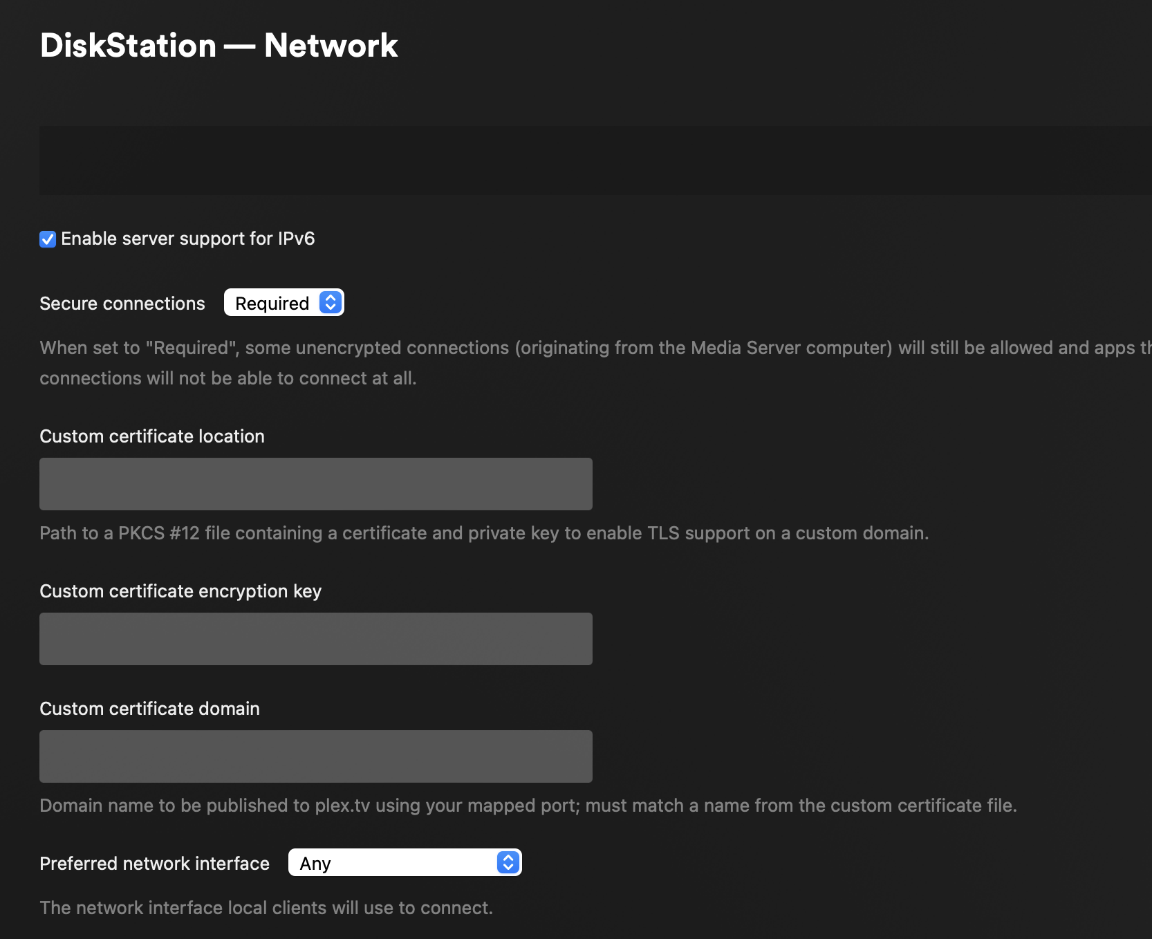

This is late and it’s still an issue. The only way I could resolve infuse not connecting to Plex was to turn of strict security on Plex. Seems like Plex certificates aren’t allowing infuse to connect in secure mode.
Thank you so much @101John. I have been fighting with this software for weeks - trying to troubleshoot why Infuse wasn’t playing my Plex Server content and going incredibly slow at getting metadata. I only use Plex on my local network so allowing insecure connections isn’t a show-stopper for me at the moment. Now I have remote access disabled and secure connections preferred - and it seems to be working.

There are likely other factors at play here, as I am able to connect, browse, and play content from Plex in the current version of Infuse (7.6.7) with this option set to either Preferred or Required. This works locally or on a remote cellular connection.
This is a pretty vanilla Plex server with almost 100% default settings running on a Synology Diskstation.
I have opened a few issues with Infuse and they have all ended with, Oh well there is nothing to be done.
I am running Plex on a Mac Mini and Infuse on an Apple TV both are latest versions. As soon as I change from Preferred to Required Infuse can not connect.

All defaults, except for ‘Secure Connections’ being set to Required.

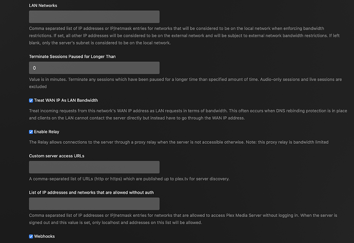

Thanks for the Plex Support page reference. I have PfSense in my network and the DNS Rebind fix described on the Plex Support page seems to have resolved the problem.
This is interesting. I have that on my router and tried toggling that on and off and it made no difference. Apparently Plex has its own DNS Rebind protection (?) and maybe that is conflicting.
I do have Plex using “required” and it’s working now, but getting there required me to completely remove al traces of Plex on my server and starting from scratch.
I have three NICs on my server. Switching all but one, en0, off, keeping DNS Rebind protection off on the router, and then starting up Plex seems to have resolved this issue. I still get errors in the console for another connection issue.
