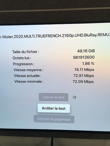

I send a report: SKQRS
My problems : when I play MKV files (4K HDR files, average 50Go) the player freeze with a buffering signal, before all My files play very good, and now play a movie it’s not possible. During a movie I meet the buffering problem 10 Times or more.
My connection os in Ethernet with a Synology NAS. To Play a movie with the player include in My OLED Panasonic it works without buffering, si why My Apple TV have this issue???
Based on the numbers in the speed test, that is not quite enough to stream 4K as you have found out. Potentially, could you try swapping out different ethernet cables. What connection do you have to your NAS? Plex, nfs, sub, etc?

Hello everybody, I found where was My problem !!!
The cause was my old Apple Airport, I connected My Synology to the free port I have on this one, and I never mind if it could Be bad or not to my media stream, and now like you can see on my speed test everything is perfect.
