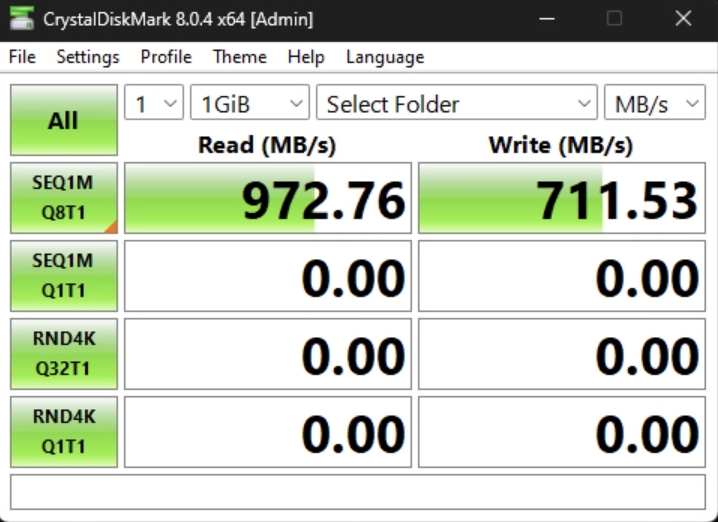

Tests between the Jellyfin host and the file server confirm 10GbE speeds, both via synthetic benchmarks (CrystalDiskMark, iperf3, etc.) and through manual testing.

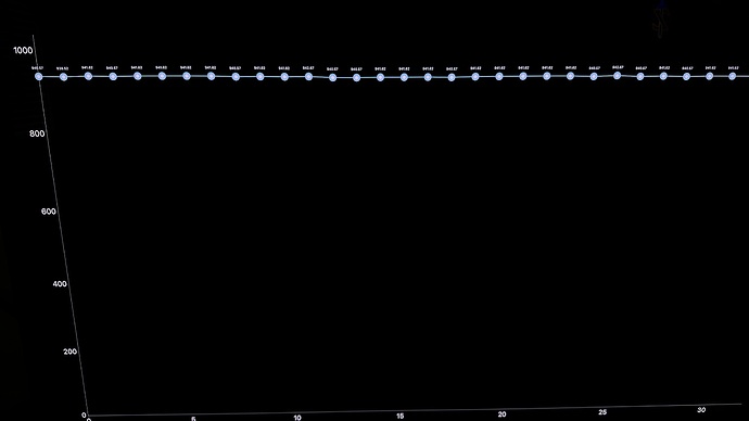

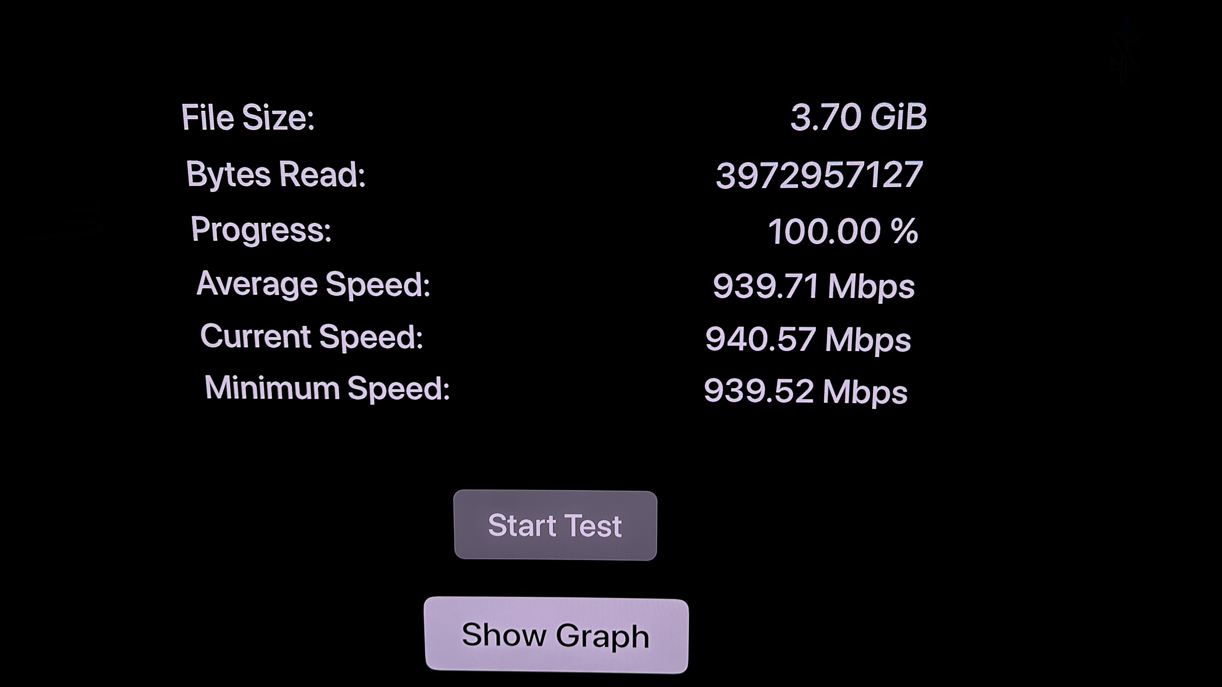

Before updating to 8.0.8, my speed test results when connected to my Jellyfin server would result in 900Mb/s+. Unfortunately, I do not remember what version of Infuse I was running at the time.

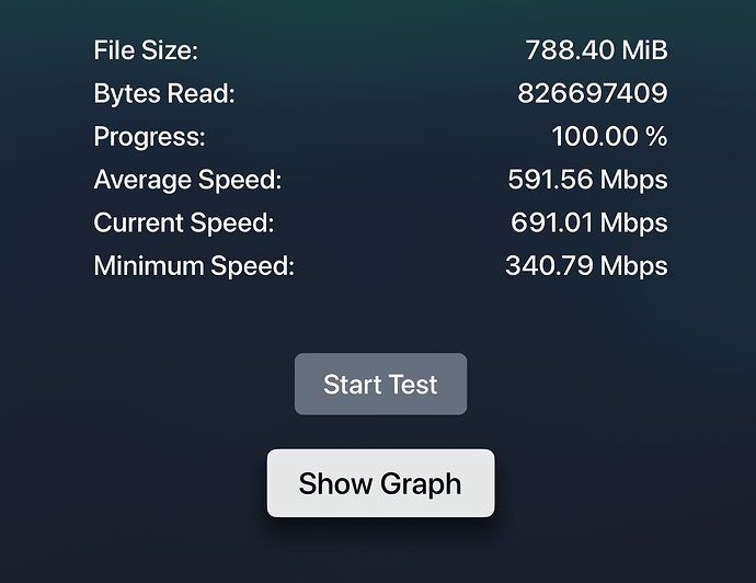

After updating to 8.0.8, my speed tests are around 250Mb/s average.This performance decrease is also noticeable when scrubbing through large files.
Here’s where it gets a little weird…

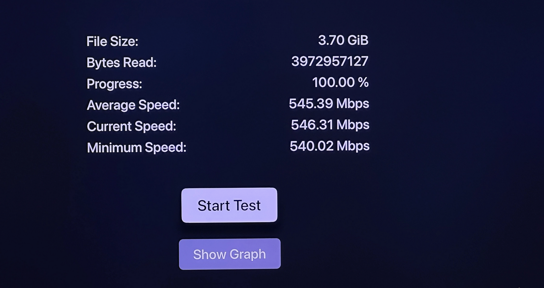

If I bypass Jellyfin altogether on my Infuse Client, and instead opt to connect directly to my NAS via SMB, I get the following results.
So what is going on here? Why the sudden change in performance? What happen to my sweet, juicy 1GB/s file transfer speeds?

Again, I was getting 1Gb/s consistently in Infuse before updating to 8.0.8. Nothing else has changed on my end apart from that. But now I’m getting 250Mb/s when connecting to Jellyfin and 550Mb/s when connecting to my NAS. I’ve historically only used the Jellyfin route and it’s been rock solid at 1Gb/s until this latest update.

Based on the two tests (Jellyfin vs SMB), you can tell there’s something strange going on because the Jellyfin test results are all over the place and are vastly under-performing compared to the SMB results. I’ve historically always used the Jellyfin server as my endpoint, so this hasn’t been an issue. I can’t explain why the SMB is still roughly half as fast as it should be, but I never tested SMB speed in the past so I don’t know if this result is any different compared to pre-8.0.8

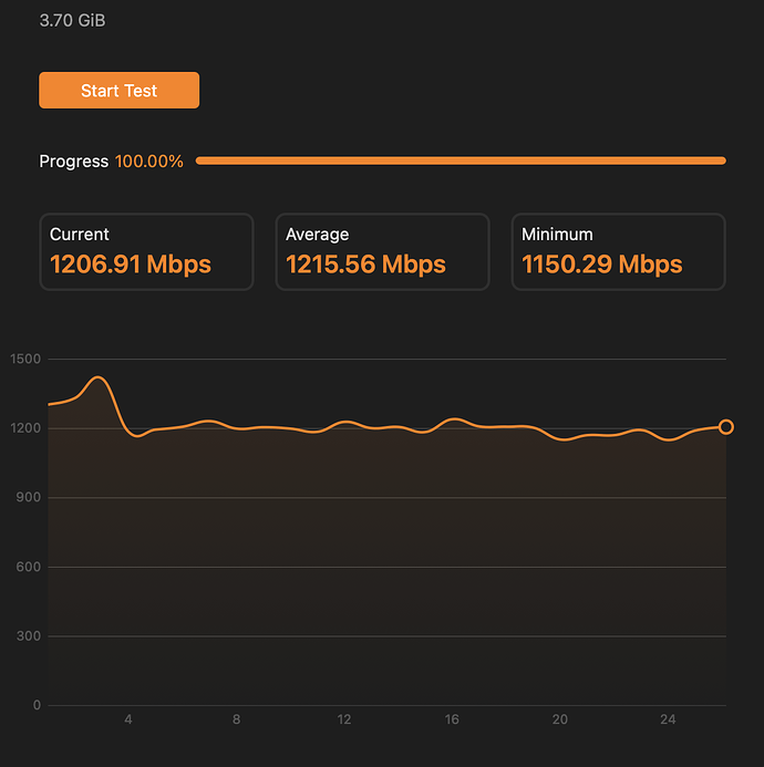

I wasn’t able to replicate lower speeds like you are seeing, so it may be something related to the network or perhaps NAS/Jellyfin settings. Here’s a screenshot streaming from a vanilla installation of Jellyfin (10.10.3) on a remote server that is hosted behind Cloudflare with Infuse 8.0.9.
A standard Internet speed test run right after shows a speed of 801 Mbps, so getting ~86% of that from a remote server seems pretty reasonable.
