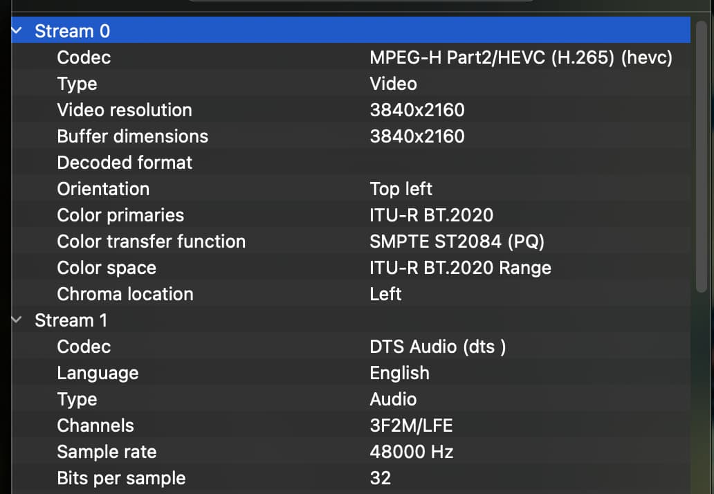

This particular file appears to have 3 front channels, and 2 middle channels. This is also known as 5.1(side). When using eARC the channels would be passed as-is, and it sounds like your soundbar may not understand how to handle this layout.
If you have a chance, can you try one of the DTS-HD MA samples found here?
