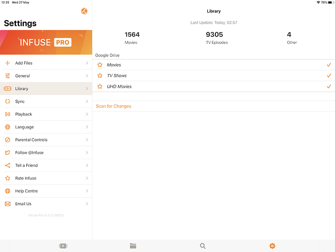

Do you happen to have the ‘Embedded Metadata’ option enabled in Settings?
Do you see the words ‘Local Metadata’ in the upper right corner while browsing via folders on Apple TV?

I do not believe if have local metadata enabled. I’m currently still using the iPad version of Infuse, the Apple TV will be done later when I’m happy with things.
I’ve attached a couple of screen shots to show my settings.

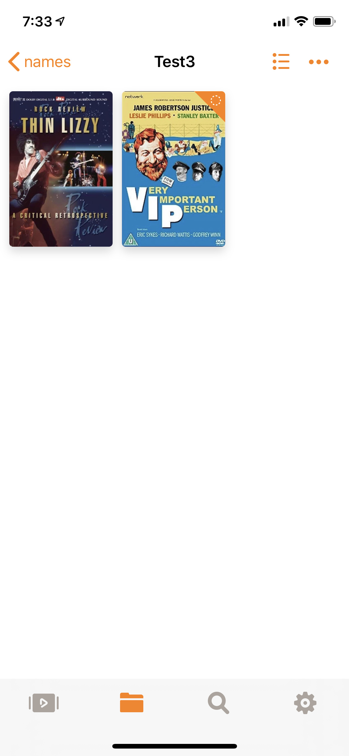

OK, I’ve now created my TMDB account and added all of my missing/incorrect artwork. All except two films, weird. The two films in question look fine on TMDB, but Infuse won’t pull the artwork for either. Double weird.
Have a look, they are:
Thin Lizzy Rock Review
Very Important Person
All others are now file, iPad and Apple TV in sync.
Cheers
Roger
There may be a delay before updated TMDb info is available to apps like Infuse.
I just tested both, and these appear to be working for me. Maybe give it another try?
That must have been it. Confirmed, both fine today. Excellent, thanks for the help.
