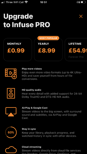

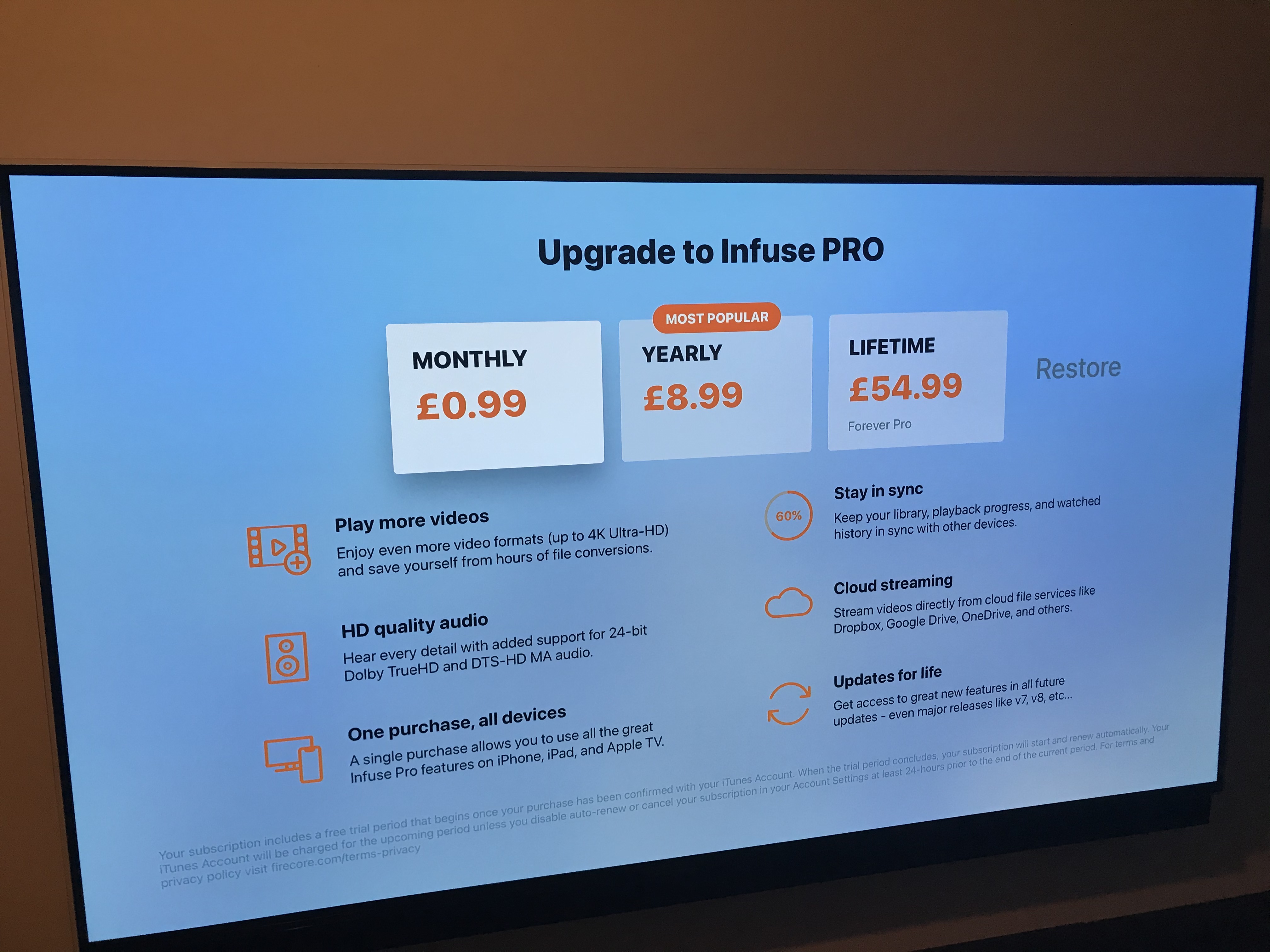

Correct. I’ve tried this on the ATV and also on the iPhone with the same results. I see the Monthly, Yearly, Lifetime options but nothing of the free year.
Can you show a screen print of what you see on the ATV Infuse settings screen in Infuse 6? Of the monthly, yearly, lifetime screen

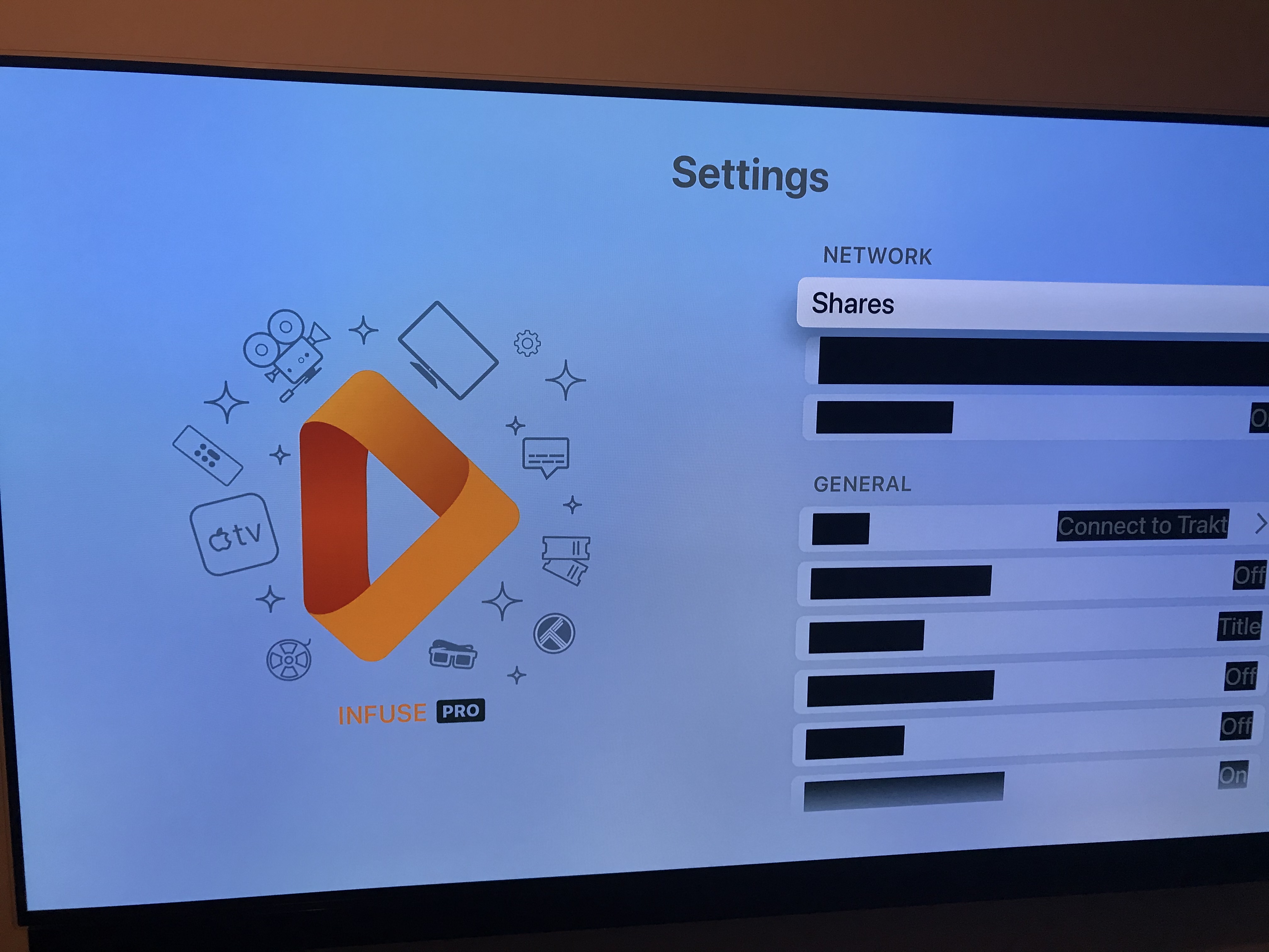

So you can see a picture of my Pro v5. It’s not happy. It’s properly broken and crashing all the time.
And you can see pictures of Infuse v6 (normal version) with no option for the free year upgrade on ATV and iPhone.
Did you every start a subscription to Infuse 6 and then cancel it? I thought I remembered you having some other issues with v5 and you were thinking of going to 6 back then.
Yes. Ages ago I started a v6 subscription but when back to v5.
That’s probably why you’re not seeing the free trial. I think that’s only for new users coming from v5.
