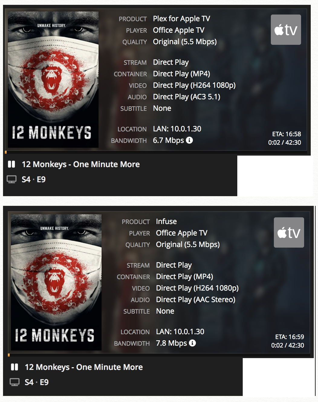

I’m having an issue with Infuse Pro 5.7.4 playing the Stereo track instead of the AC3 5.1 track. On the Apple TV side I’ve tried setting “Video and Audio > Surround Sound” to “Best Quality Available” and “Dolby Digital 5.1” both settings result in stereo being played. I also set my Infuse “Settings > Language > Audio” to “English (United States)” and played with “Settings > Audio Output” and tried “Auto” then “Passthrough”. “Passthough” just plays a loud screeching noise and “Auto” still outputs Stereo. I’ve also manually changed the track while the video is playing to “Track # 2 (English, Dolby Digital)” but that also still yields stereo output. When I play this video via Plex on the Apple TV the AC3 5.1 track plays and works as it should. It’s only via Infuse that I can get nothing more then stereo to output.
Here is some info from ffprobe, and I’ve attached the output of PlexPy showing the video playing with the AC3 5.1 track manually selected.

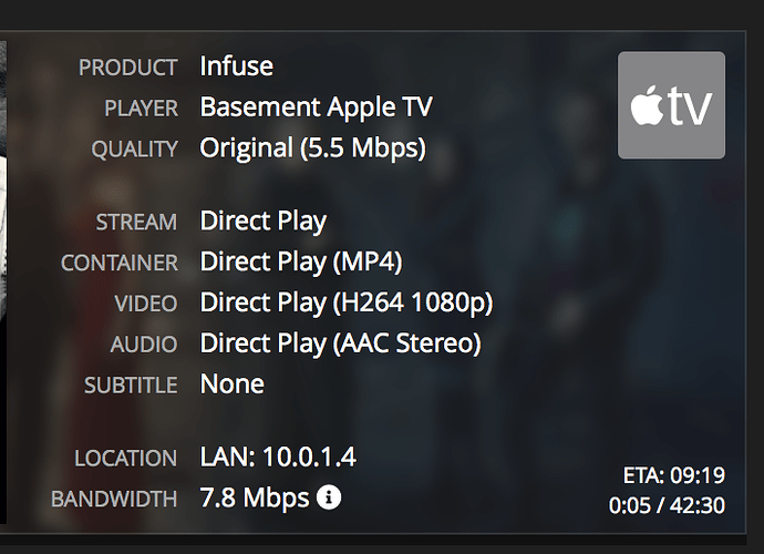

Thanks for all the replies. I decided to give this a go on another setup I have in another room. It’s similar to the other room I’ve got… Sony 4k TV, Pioneer receiver and Apple TV 4k. All hardwired via HDMI and ethernet. I still only get Stereo in Infuse but in the Plex client AC3 5.1 (same as the other room). I’ve attached some PlexPy screen caps to compare with. Same Apple TV but one is the Plex client the other Infuse.

I decided to actually listen to what was coming out of each speaker even though Tautulli was reporting stereo and it sounds like 5.1. Voices are coming out of the center channel etc. Is it possible Tautulli is just reporting it wrong here?
I also created a share from my laptop and served up that video file. Upon listening to each speaker it also sounded like 5.1 was working.
Its possible that Tautulli is reporting it incorrectly. Maybe its reporting wrong due to the default flag on the stereo track? I would try removing the default flag from that audio track and see what Tautulli reports after that.

Yeah personally it sounds like tautulli is only reporting the default audio (aac) no matter what audio track is selected.
