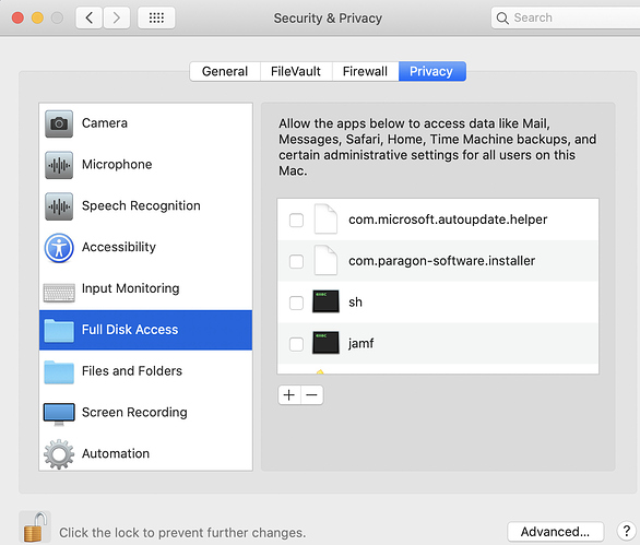

Well, I saw this post of you and immediately looked at the Full Disk Access in system prtefs, but saw no icon for terminal smbd… Please see the following screen shot

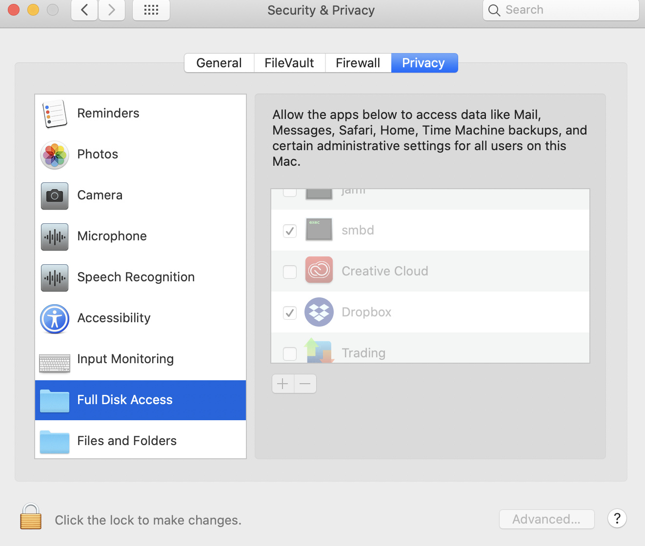

Did you try disabling file sharing and then turning it back on per the part “disabling File Sharing appears to also disable full disk access for smbd. Re-enabling then re-enables it”?

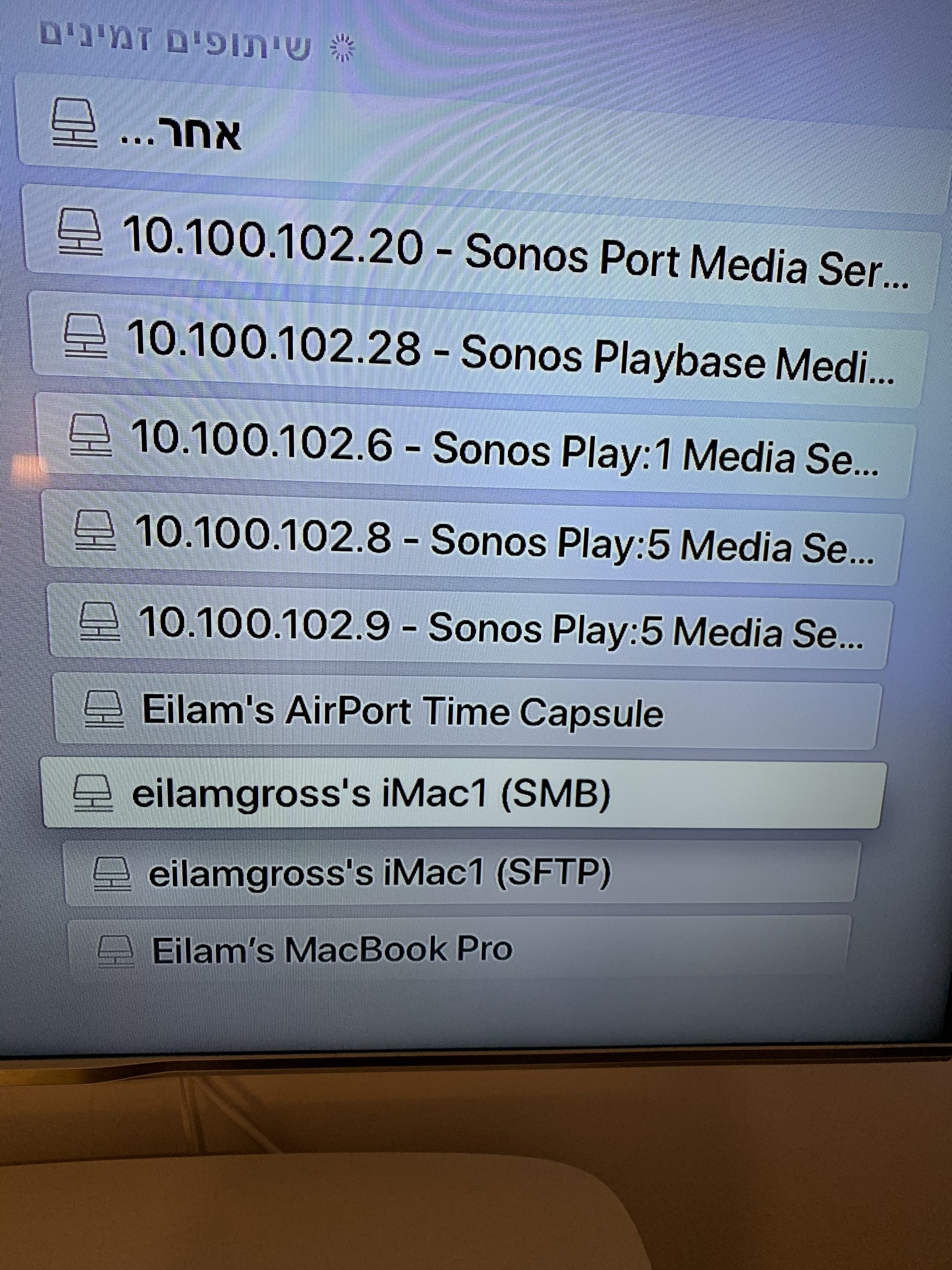

Thank you for the advise. It did bring back smbd , however, I can still not access the imac and the folder (see picture). When I turn off File Shatring INFUSE Does NOT see the disk, when I turn it on, it sees it but fails to access it. Please help.
See another photo from INFUSE screen

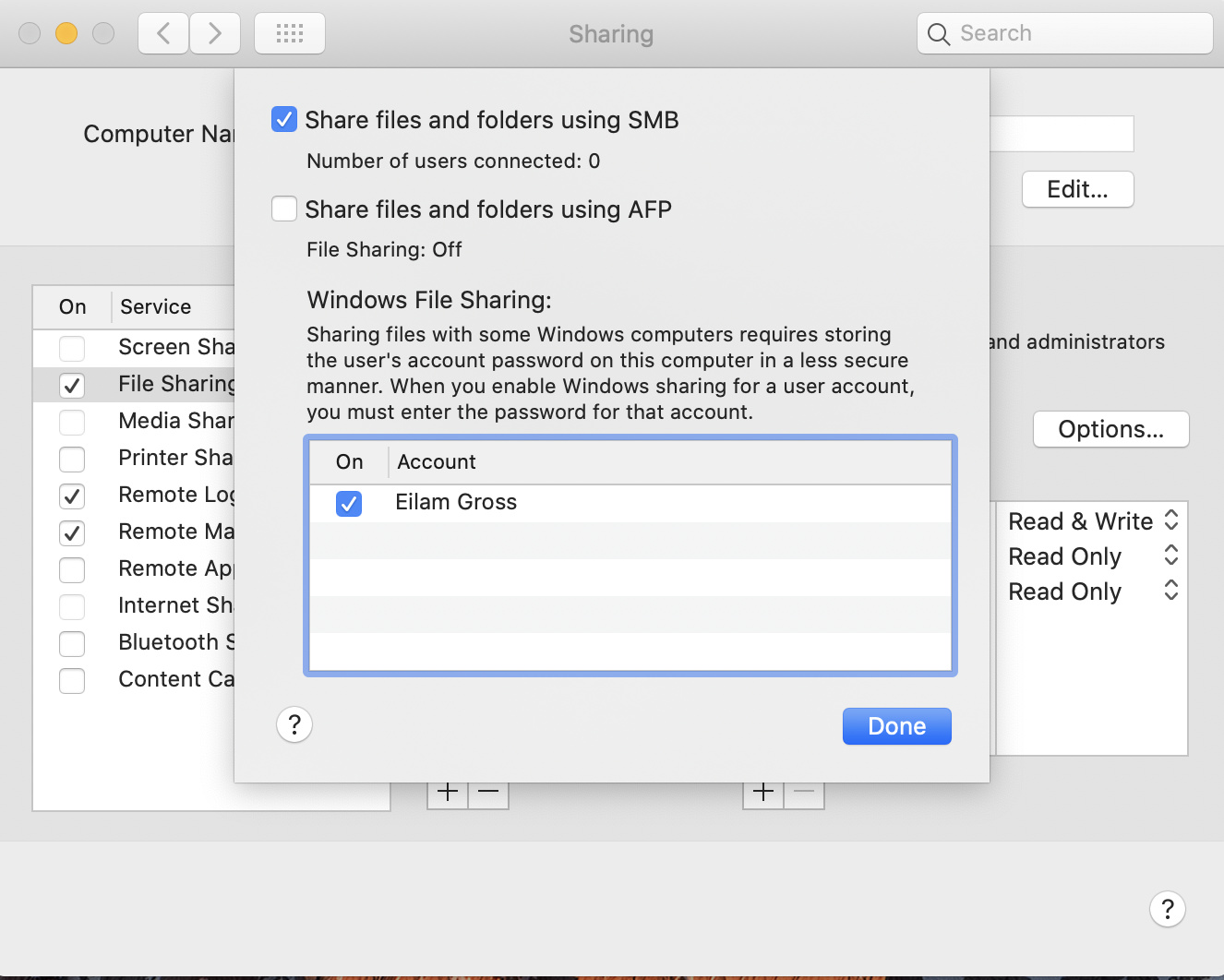

There are a few things to check.
  1. SMB is enabled on your Mac (more info here Set up file sharing on Mac - Apple Support).
  2. At least one user is selected under ‘Windows File Sharing’ (as shown under ‘Advanced Options’ in the link above).
  3. Selected username and password are being entered in Infuse.
Note: iCloud username/password cannot be used. If you’re using an iCloud ID to log in to your Mac, you will need to set up a new ‘Sharing Only’ user as described here: Change Users & Groups settings on Mac - Apple Support

I send you now a series of photos that indicate all is fine, but I cannot connect. I reinstalled Catalina… < i tried everything and it just wont connect.
