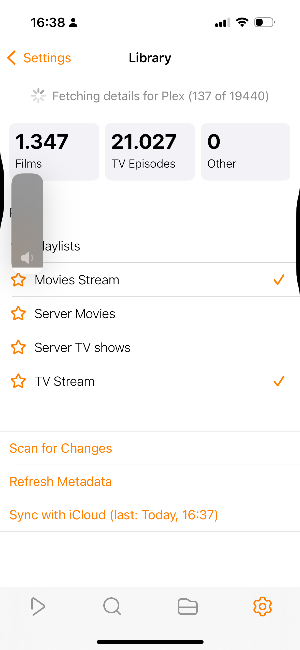

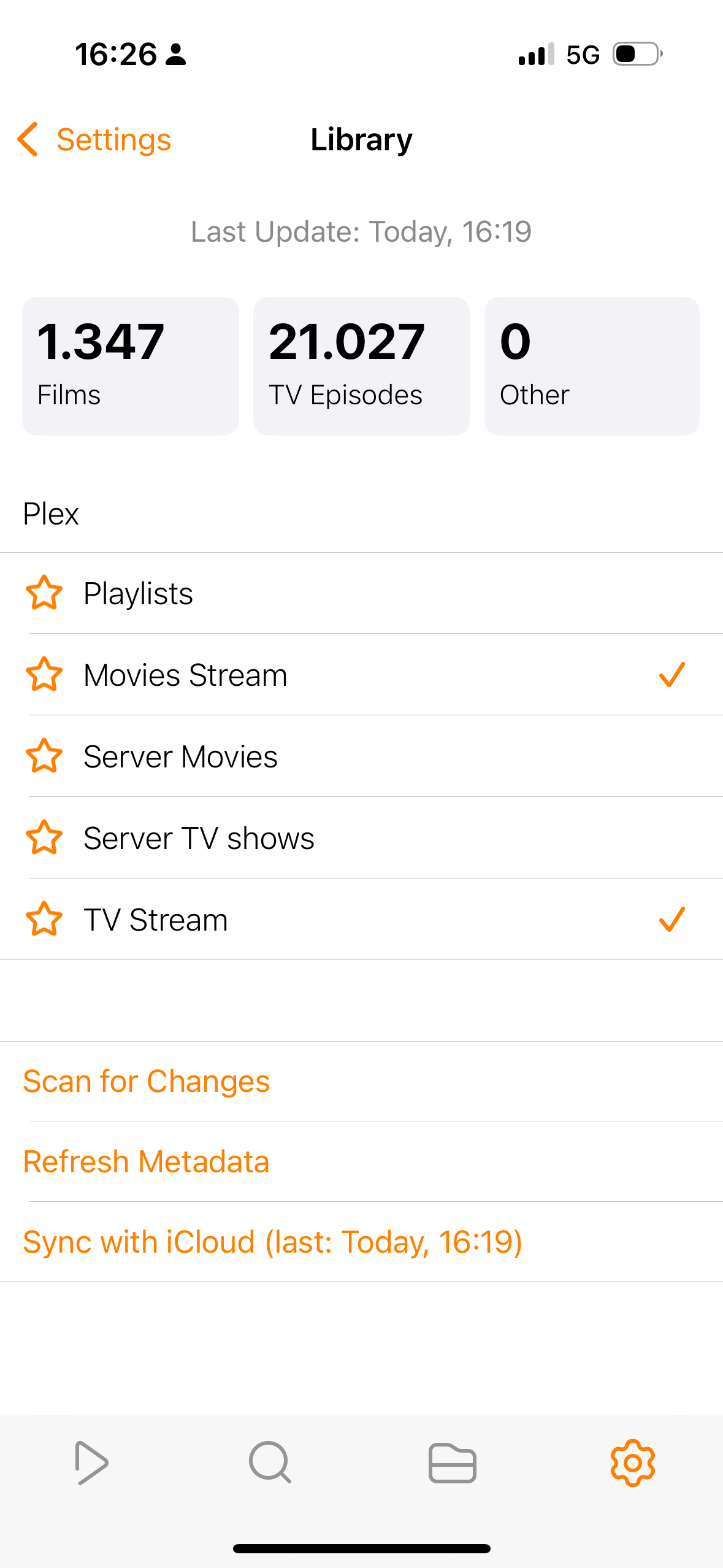

Hi, I’m having a weird issue, I’m connecting infuse to my plex server in library mode. One of my libraries (the TV one) is a large library. If I’m connected to WI-FI I get indexing failed issue. But if I connect my Apple TV to my iPhone phone hotspot it instantly indexes and all goes well. - tested this with infuse on 2 Apple TVs iPad and iPhone all the same, if I’m connected to the WiFi(same network as plex server), won’t index, if I’m connected to 5G, will easily work.

This is the one while connected to 5G: D60V4
Now that I have all episodes already accounted for, I don’t see difference as nothing new was added, but still, on same network gives the same error as before where episodes wouldn’t be listed, and on 5g no error, same as when I managed to actually index things
One more update: QRAQJ actually fetching while on 5g
