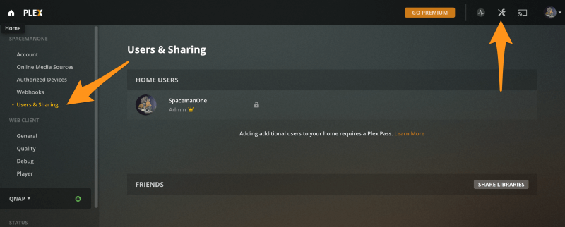

Edit to add, was reading here and it looks like a place to maybe check.
