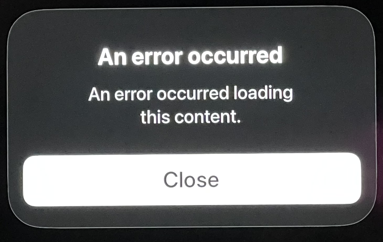

Hi, I recently replaced an old self built NAS which never hibernated with a Synology which does (and uses much less energy when asleep).
My tvOS Infuse library is fed by Jellyfin with library mode on.
I’ve never had playback issues in Infuse with the old NAS, I imagine because the hard drives didn’t idle.
With the Synology, if it’s hibernating and I open Infuse, navigate to a movie/show, hit play - I get a spinning orb for about 5 seconds followed by the message ‘An error occurred loading this content’:
If I close the message and hit play again it loads fine. I assume because the Synology was woken with the first request.
I’ve seen other similar threads which have suggested adding the server MAC address into the Advanced section of the Share to send a WOL request. But this isn’t available for Jellyfin shares.
Could the timeout be extended/add a retry on the first play attempt to allow the Synology to wake up and serve the content? Or any other ideas?

It seems that the current timeout is 25 seconds or so. My devices wake anywhere from 35 to 45 seconds. So for me, I think 1 minute would be a good amount.

  • Ensure Synology is hibernating, hit play in Infuse, then using the Siri Remote exit back to the show/movie info screen before the error pops up. Then as soon as possible hit play - it plays fine. So the timeout increase doesn’t have to be long.
  • On Windows with MPV player… Opened file explorer showing a movie file stored on the NAS. Waited for the NAS to hibernate. Then dragged the file from explorer into MPV. The NAS woke up and the file played. It took a little while whilst it waited for the NAS to start serving, but no errors. Subsequent attempts were instant as expected.
  • On iOS I added my shares via NFS. Same timeout issue, this was just to rule out Jellyfin libraries being the cause.
In the Windows and MPV test above I timed it at about 15 seconds. This was from dragging and dropping the file to playback starting.

Interesting. When I measured (post 9), I got about 15 seconds. But I get timed out on both iOS + NFS and tvOS + Jellyfin. Might do some further testing.

Further test, this time on tvOS using the VLC app. Connected to the NAS using NFS. From pressing play whilst the HDDs were hibernating to playback starting took 26 seconds. And more importantly - it didn’t time out like Infuse does.
Significantly longer time than my Windows test. However, this time I was watching the NAS and the HDDs were definitely hibernating when I hit play on the remote. I don’t have line of sight with my Windows machine - I’m going to retest that. There’s a chance I already woke it before testing playback.
