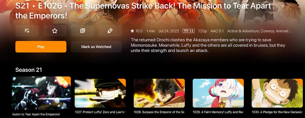

I’m not sure if it’s the way you’re numbering the episodes with the 21X1024 or other issues but I named the files like this.
Test for Pierred78 File name and structure
And that gave the correct results with the correct episode numbers.
I’d suggest you try the file naming as above in my example using S21E1024 instead of 21X1024
Yes it’s working !
Thank you very much NC_Bullseye :slight_smile:
Everything is good now.
