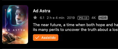

OK so I deleted NFO file for Ad Astra, used the Edit Metadata option to re-select the movie title and it now shows as HDR.

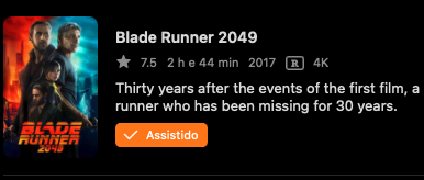

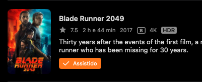

Tried the same with another file but without touching the NFO file, just using the Edit Metadata trick.
Before (NO HDR):
After (HAS HDR):

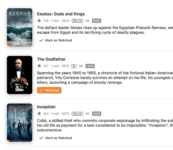

I wasn’t able to replicate this here with the NFOs, and all of your other uploaded files were tagged correctly as well.
These 3 files are using all of the same 1min HDR sample, and your NFO files for the 2nd and 3rd titles.
Since the issue appears to resolve itself when reloading metadata for the affected files, I guess that would be a solution for any remaining files which are affected.
Perhaps the original issue stemmed from Infuse not fully completing its indexing, or perhaps starting to index files that were in the process of being copied/transferred between locations. It’s hard to say.
