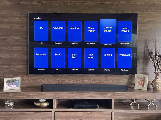

While I finally got Infuse to show folders up front by adding a ‘_’ to each of folder names, the issue still remains that when using a sort by filename ALL MOVIES beginning with ‘The’ are unfortunately grouped together and placed in the T’s. PLEASE PLEASE, can an option be added to filter out “The”. Example with that filter in place, ‘The Hunt for Red October’ will be placed in the H’s where it belongs.

Folders on top and ignoring ‘The’ when sorting.
Well don’t know what I was doing before but took your advice. When into Infuse on the apple tv4k and changed the sort to title. Sure enough, folders are at the top AND I don’t need a special character on the front side of the folder names to force them to the top anymore. Plus, ‘The’ in titles are ignored! All of this is with using an SMB share. Thanks to all for getting me straight on this. Much appreciated!
Now to see if this will all work when using a Plex share vs SMB.
Infuse 7 ROCKS!

Tried the Library approach. Subfolders do not appear at the top. Collections has been an ongoing issue since Plex themselves brought it on. The concept is understandable but the application is not up to what it should be. One example, they are not displayed at the top of the grid and instead burried in the sort. So you go to watch something you have to continually scroll down to get to the collection . Ergo, the use of folders which is a simple straight forward approach that everyone in the household gets. Kid’s Movies, Chich Flix, Star-Wars, Star-Trek, Westerns etc. All right there on one screen. Anything else, scroll down.

One would be a folder view which would display all the folders you have set up.
