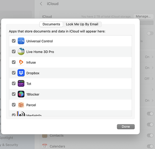

You may also check to ensure Infuse is enabled for syncing with iCloud Drive in System Settings > iCloud.
