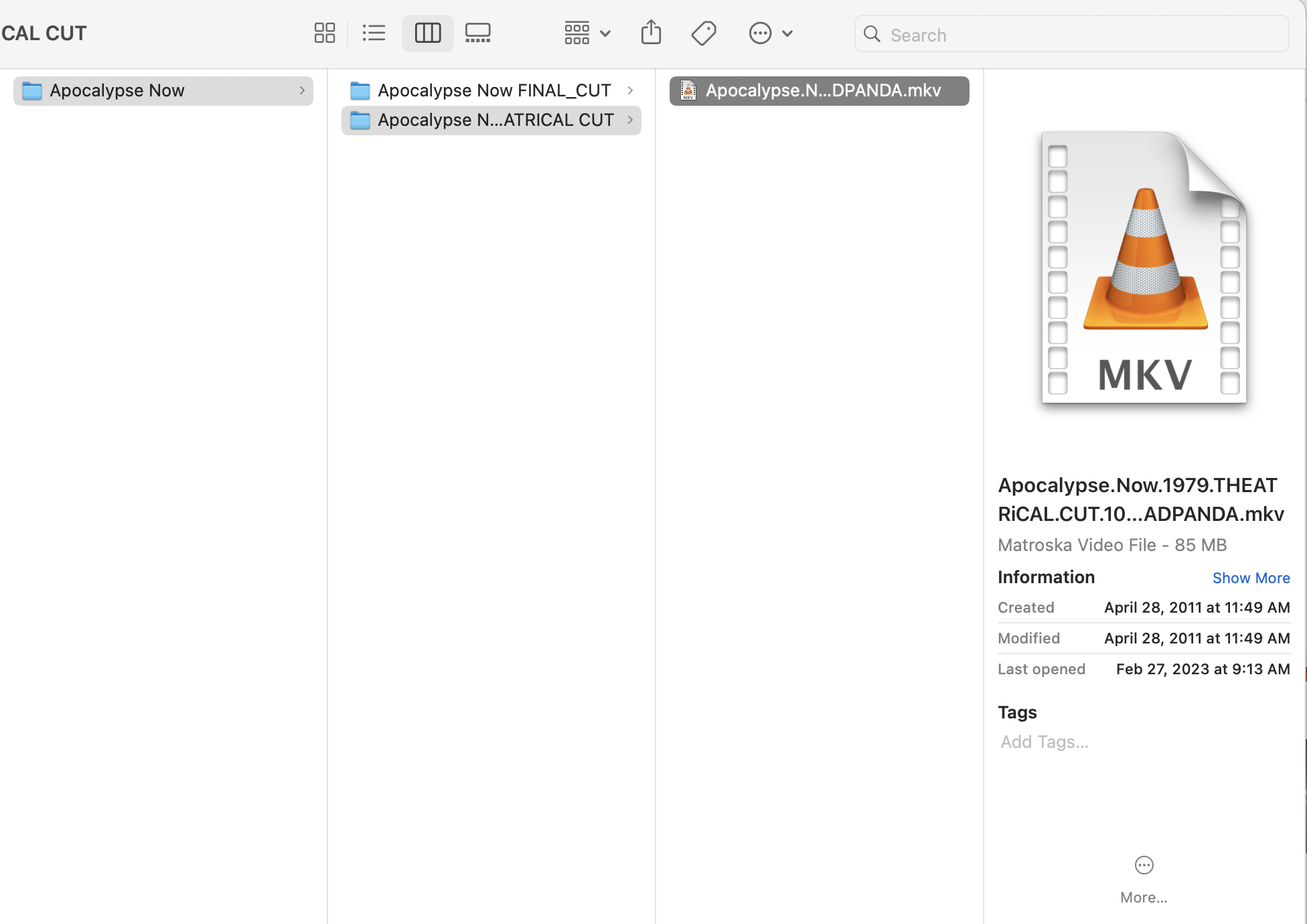

Can you show the exact filenames you are using for both?
Folder Apocalypse Now with two subfolders
  • FINAL_CUT with file: apocalypse.now.1979.FINAL.CUT.2160p.uhd.bluray.x265-terminal and I also tried apocalypse.now.1979.{edition-FINAL.CUT}.2160p.uhd.bluray.x265-terminal
  • THEATRICAL CUT with file: Apocalypse.Now.1979.THEATRiCAL.CUT.1080p.BluRay.x264-SADPANDA and also tried Apocalypse.Now.1979.{edition-THEATRiCAL.CUT}.1080p.BluRay.x264-SADPANDA
They are all Matroska files
For single item folders, you will want to include the title in the folder name as well.
EG
Apocalypse Now
Apocalypse Now/Apocalypse Now FINAL_CUT/videofile.mkv
Apocalypse Now/Apocalypse Now THEATRICAL CUT/videofile.mkv
Alternatively, you can eliminate these subfolders and just place both videos into the main Apocalypse Now folder.

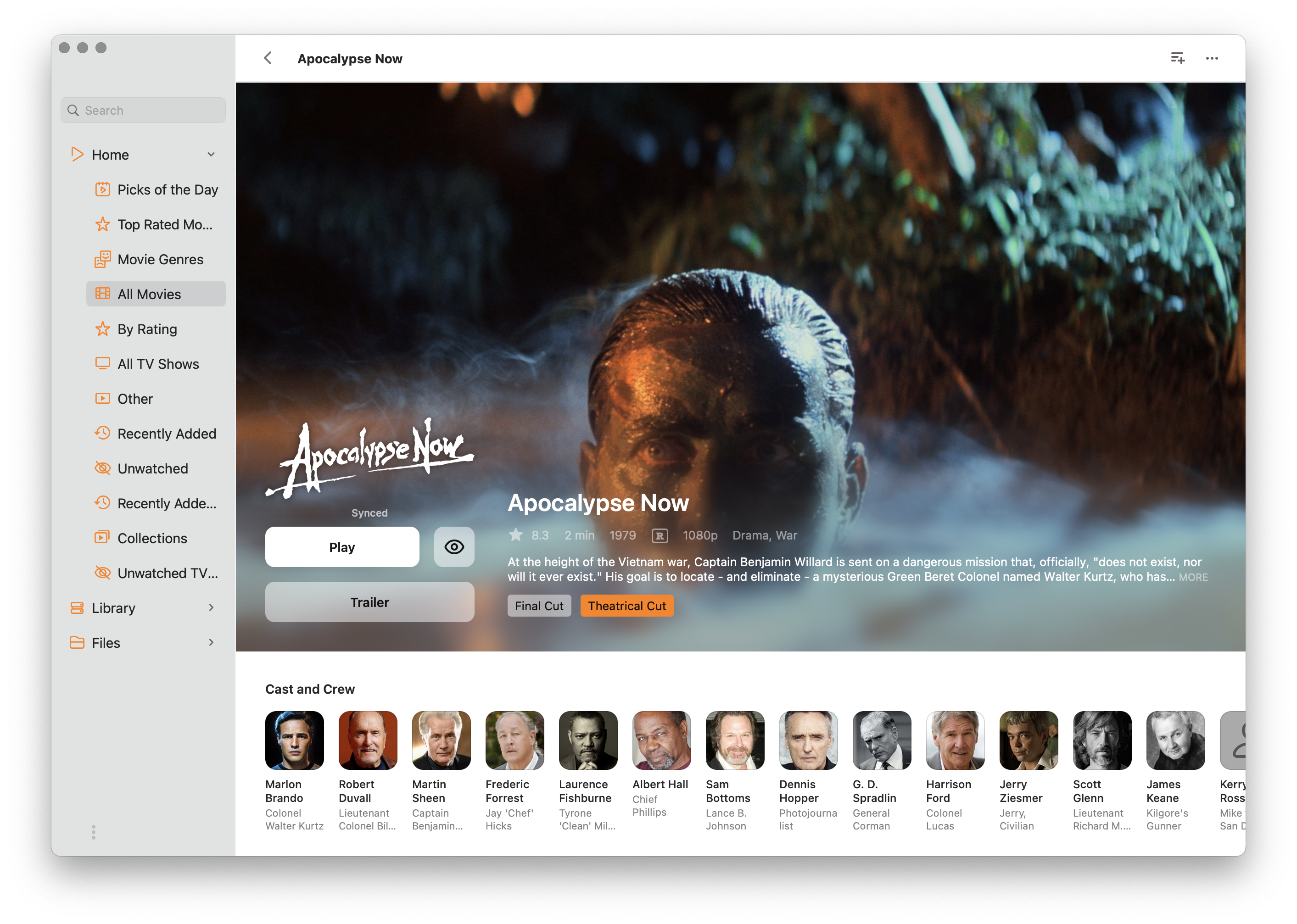

Here’s what I see when using those filenames (no edition tag needed).
Yeah that seemed to do it, Now get 1080p theatrical cut and 4K HDR Final Cut. Thank you very much!
