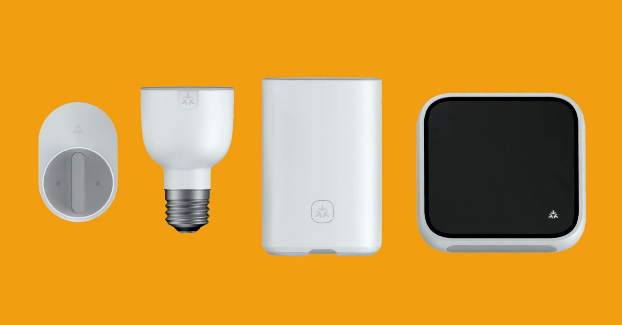

The Threads/Matter standard is very close but not in operation yet that would allow all devices manufactured by companies adopting the new standards.
Also, it takes a second gen ATV4K to support Threads.
https://discussions.apple.com/thread/253929730
Here’s a good run down on Matter.
