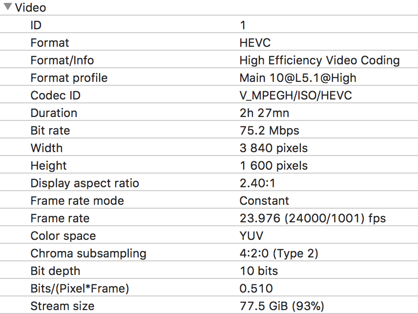

Video details, see attachment.
When i start the video in Infuse it starts playing ± 1 second, then starts buffering. On the NAS side i can see it’s hitting 10MB/s - 11MB/s but it stops there, not enough to play and/or buffer the video. But i’m not quitte sure why it’s capping on 11MB/s.

Attached are some video properties of the file I tried.
