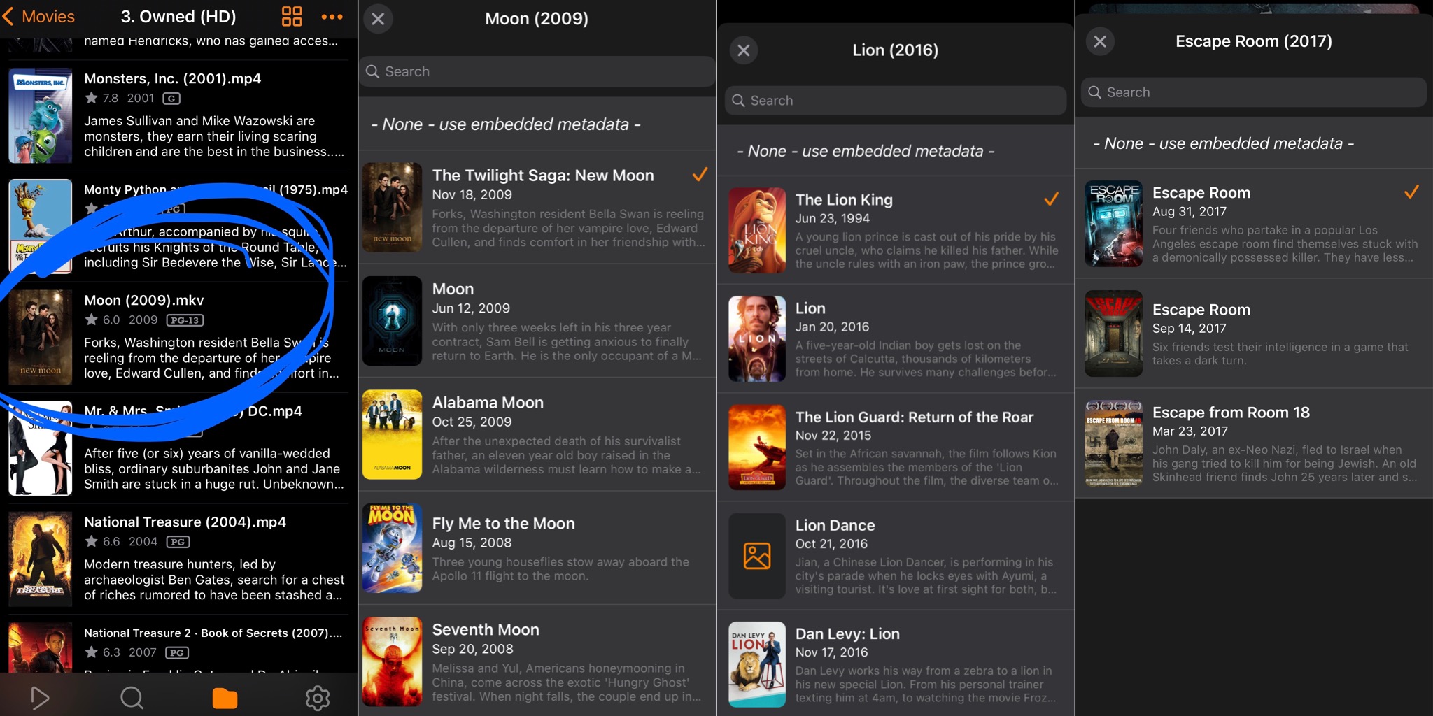

The movie is the outstanding “Moon” from 2009. It’s named “Moon (2009).mkv”. Infuse / TMDB identifies it instead, frustratingly, as “The Twilight Saga: New Moon” (also from 2009).
Edit to add: Also discovered same issue with “Lion” from 2016 (scraping as ‘The Lion King’ even though that movie came out in 1994!) and I can’t figure out a way to scrape the 2nd movie to come out in 2017 with the exact title “Escape Room”…

TMDB search seems to default to illogical choices when movie titles are short and more popular titles share common words.
Who do we talk to about that? I mean, you’d think if I actually had “The Twilight Saga: New Moon” I’d have put “Twilight” in the filename. Or, at the very least — the word “New” (as in “New Moon”).

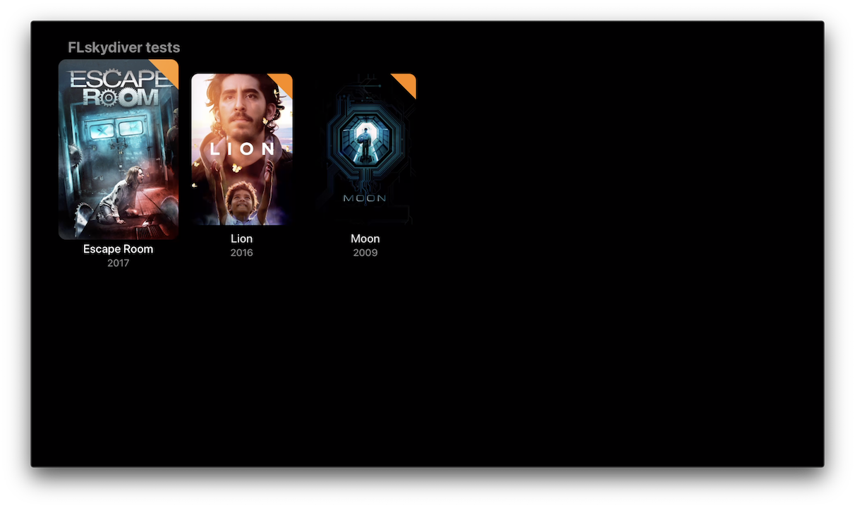

Here’s the file names I used (note no parentheses)
FLskydiver file names
Here’s the results Infuse retrieved automatically with no editing needed.
Are these the right ones?

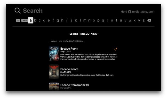

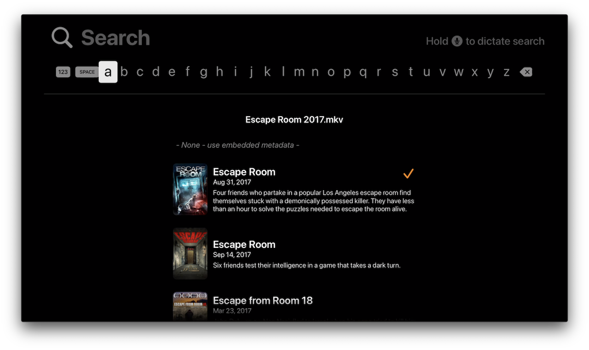

Edit to add, I see you said the second release of escape room for 2017. I clicked on the “Edit” button on the pre-playback screen and here’s the suggestions.
Is the one you want the one below the one with a check? If so that’s an easy fix, just select it and your good to go.

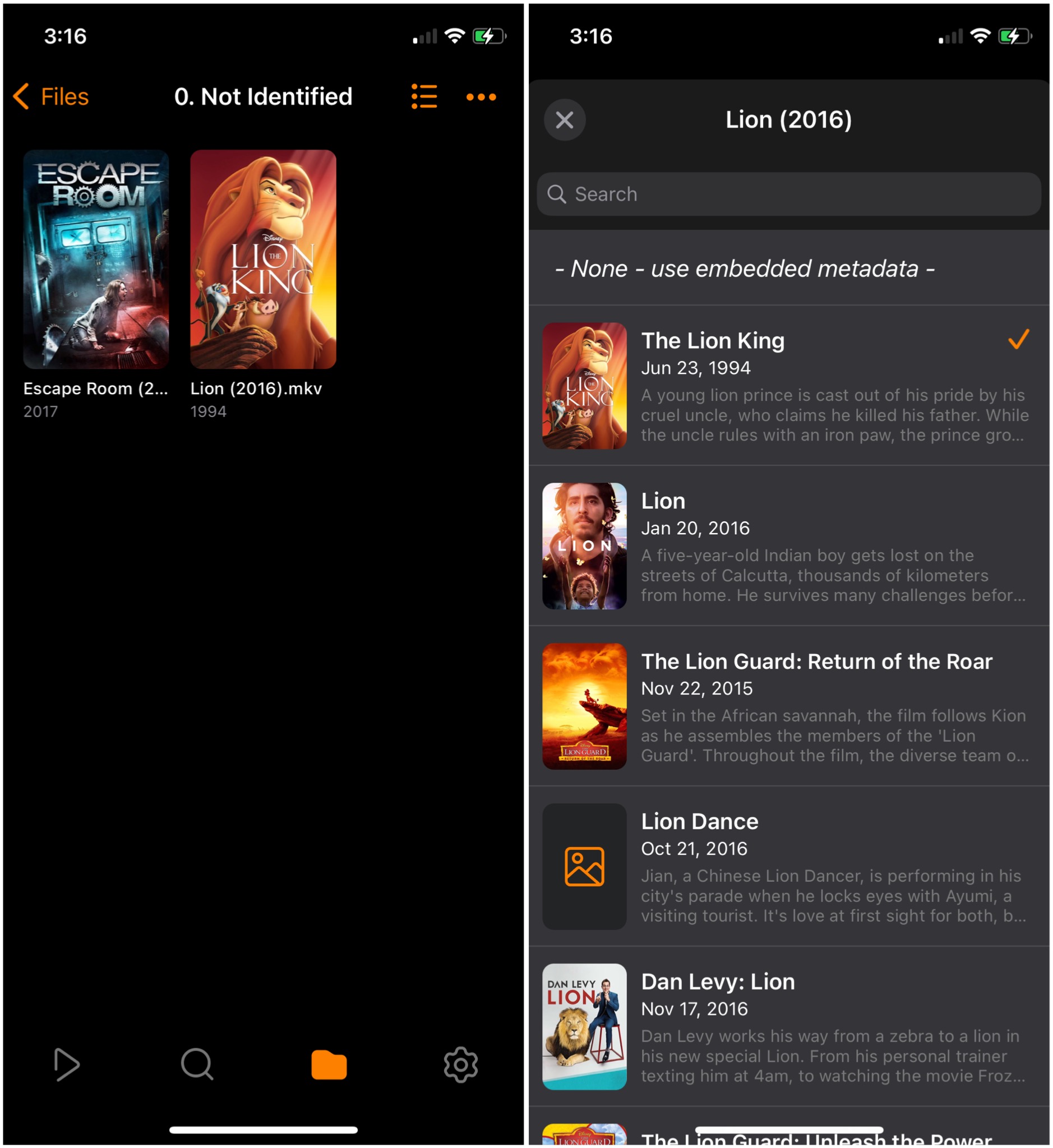

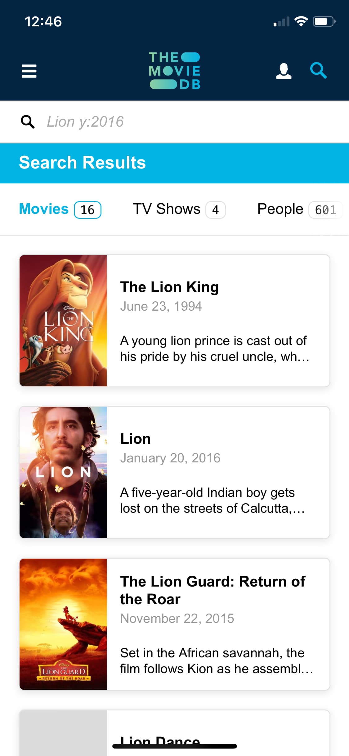

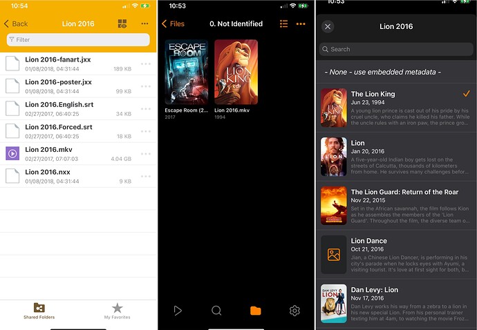

Still no bueno on “Lion”, though — parentheses or not. I get same results from web search on TMDB.
And yeah, the “Escape Room” movie wanted is the 2nd one. I guess the only way to get that to work is finding out if there is an alternate title.
Or just deleting it from my collection since I’ll probably never watch it anyway.
I see what you’re getting in TMDB, what are you getting in Infuse? That’s where they will show correctly. You may have to do an Edit to get them to see the changes but it will work.
On the escape room, click on edit in Infuse and it should show you both of the 2017 releases and then just select the one you want. As to the others they’ll come up correct with the name change and an edit to select the right one, save the curses for the neighbors dog at 3 in the AM.

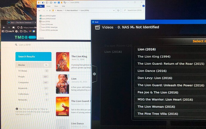

Only Kodi’s python API pulls the correct result without user needing to correct it.

Okay, it looks like you still have the parentheses in the title and that may or may not be one of the gremlins but on the Lion phone screen even though you have "the lion king checked isn’t that the correct movie just below that?
Can’t you just check that movie and have it corrected? Secondly if that doesn’t stick, have you tried entering the movie name on that same edit screen above the selections in the box using the keyboard?

I’ve tried removing parentheses but it hasn’t made a difference.
Of course I can get it right by manually moving the check — but since I frequently rebuild the library and need to do so on multiple devices, I don’t want to have to remember to do so each time. I just want it to work! I mean, I’m so close now!

So I noticed this past hour that when I did a manual edit metadata search on my Apple TV for “Lion (2016)” on my Apple TV, that “The Lion King (1994)” is no longer an option — neither the first result, nor, curiously, any other — for this movie.
That struck me as peculiar, since I had just minutes before checked again on both my iPhone and themoviedb.org and “The Lion King (1994)” still ruled supreme … as ‘King of the metadata usurping Jungle’, you might say.
So, what was the difference? My Apple TV had updated to Infuse Pro v. 7.3 (3947); while my iPhone was still on the previous version. So I update my iPhone, and my copy of “Lion (2016)” magically updated to the correct movie (from its previously incorrect assumed identity as 1994’s The Lion King).
So, this makes me think someone at Firecore must have changed something in Infuse. If so … First and foremost - Thanks! …
But I’m also curious. Was this a change in code to address this very specific title or something that applies to all titles globally, in a way that just happens to address title mismatches such as this one?
A response I received to a post I made on TMDB noted that the reason ‘The Lion King’ appeared as an answer to the query Lion y:2016 was, apparently, that The Lion King had its Armenian television premier in 2016 (per IMDB; a release that is 2nd from last in a list of hundreds). Not sure why that alone would merit an identification of “The Lion King (1994)” over the seemingly obvious choice of “Lion (2016)” for the query “Lion (2016)” … but did someone at Firecore figure out a way to overrule such (il)logic and decide to change the way Infuse processes search results or submits its queries?
