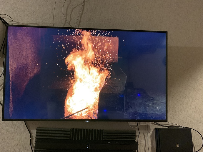

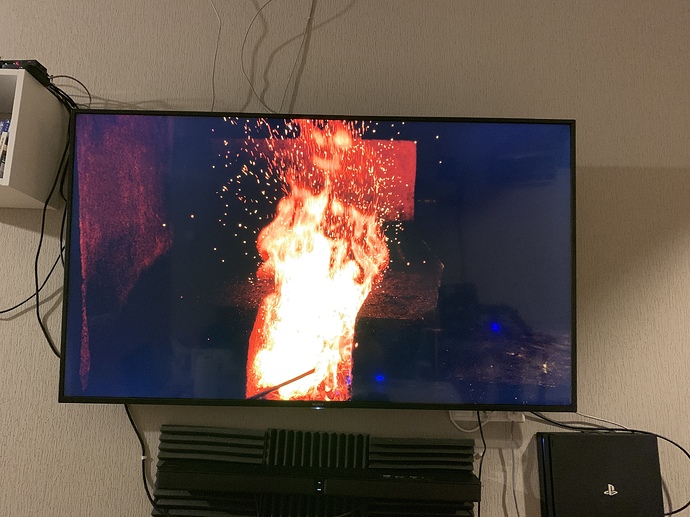

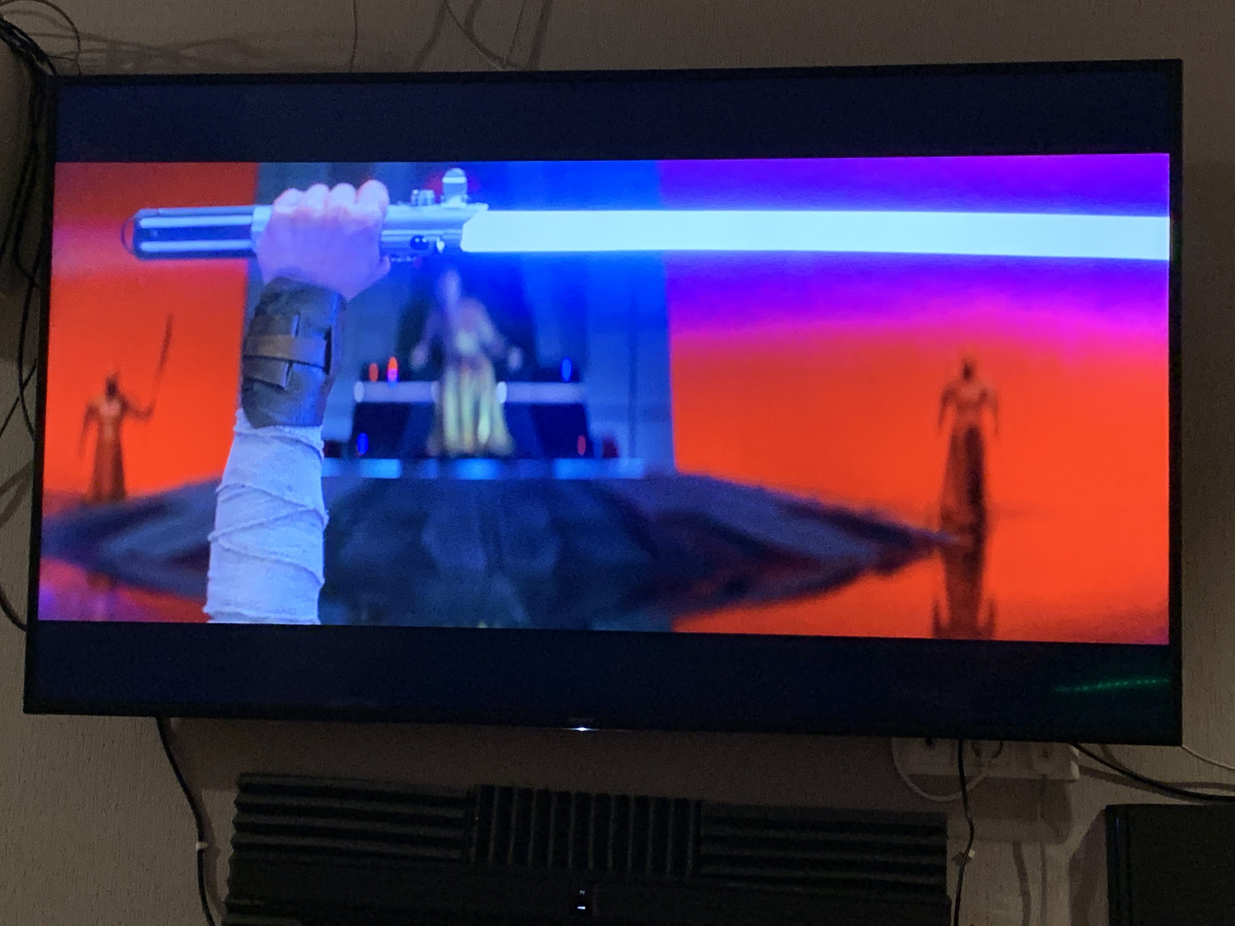

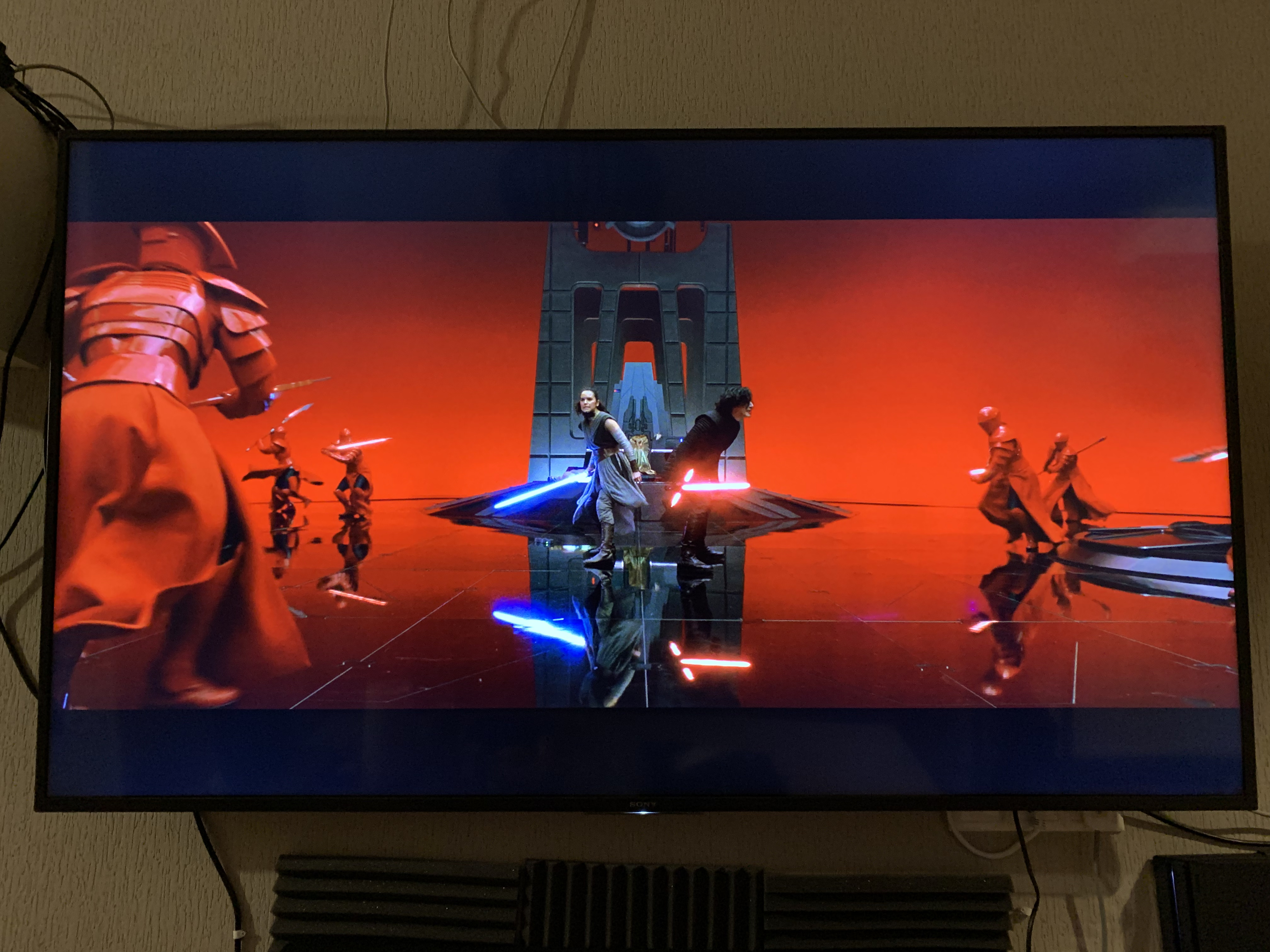

some samples

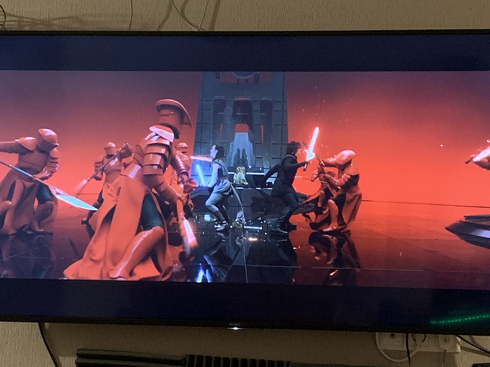

ps4:
08176f4c-4521-45a4-ba99-6b453cc8d899
622824fd-57fa-4504-9f1c-394dca782837
atv:
34a4f1b1-556f-4d29-b666-b7effce260dc
5397a10f-16f3-4c7c-bd41-8c1fcf18a0ac
picture doesnt capture as much as seen in real but you still see color disruption
light saber isn’t even blue in some frames on atv

Are you seeing a difference between the two devices when playing the HDR samples?
While it’s clear from your screenshots there is a difference between the Apple TV and PS4, without a calibrated benchmark it’s difficult to tell from here which is correct. It’s very possible the Apple TV is correct, and the PS4 colors are over saturated.

when hdr is not enabled on appletv this file doesn’t display any color only greyscale so HDR is defiantly on. and ps4 just switches it on automatically when hdr movie is played. all remote configurable settings are matched i took picture on ps4 settings and replicated when appletv is connected it makes it tiny bit better, but as you can see in images its way way off, and has white overlay on top of it
