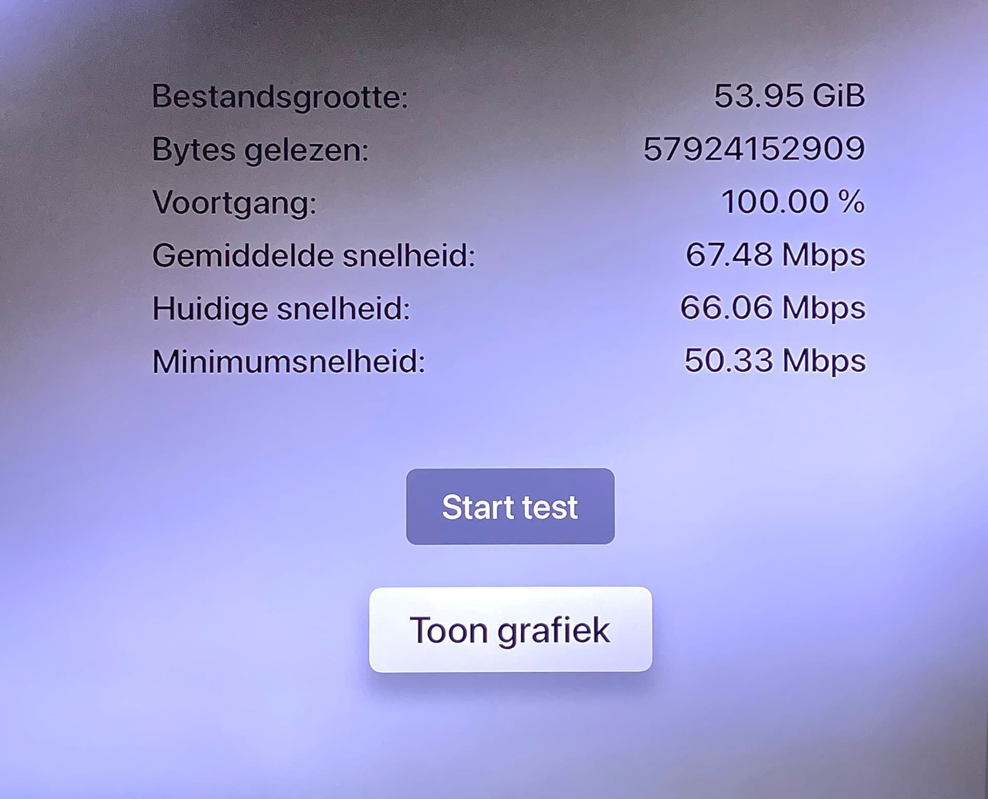

Since 2 updates ago I have problems with some HDR movies to play smoothly. Some MKV and BMDV files, after a moment, the movie stops and the turning wheel appear on the screen and after 20 seconds the movie continues. I already contact Firecore but no reply to solve the problem. I reboot Apple TV 4K and I thought, this the solution but after a while the problem returns. I read more people have same problem… Is this a bug in TV OS? Or a bug in Infuse 7 Pro which still not solved?? Please solve this problem, this is so annoying… Before the last 2 updates of Infuse, never had this problems with the same movies, played always smoothly, what is going on? This issue also happens on Infuse for iPhone. Infuse on Mac seems working good
Can you run a speed test in Infuse for this video that stops for 20 seconds and then resumes? Run the full movie in the speed test and then if you would, post screen caps of the results and a screen cap of the graph. That may help the devs figure out your problem.
How can i run a speed test in Infuse?
Settings > Shares > Share Name > Speed Test.
Thanks, i will do it
Here the speedtest of one of the HDR movies which has the problem, Most the time are big file HDR movies
How is your ATV connected to your network? WiFi or Ethernet?
What protocol are you using for the share? SMB, FTP, DLNA, etc?
Connected via Ethernet. Protocol SMB
First thing I’d try is changing the SMB to SMB2 and test the speeds and then try the SMB Legacy setting and again test the speeds.
If neither of these increase your speeds then I’d suggest trying a new Ethernet cable (even just a temporary cable run across the floor for testing) and test the speeds.
One additional thought, try unplugging and re-plugging both ends of the cable several times. I’ve seen Ethernet cable connections get flaky and this seems to get them back in shape sometimes.
