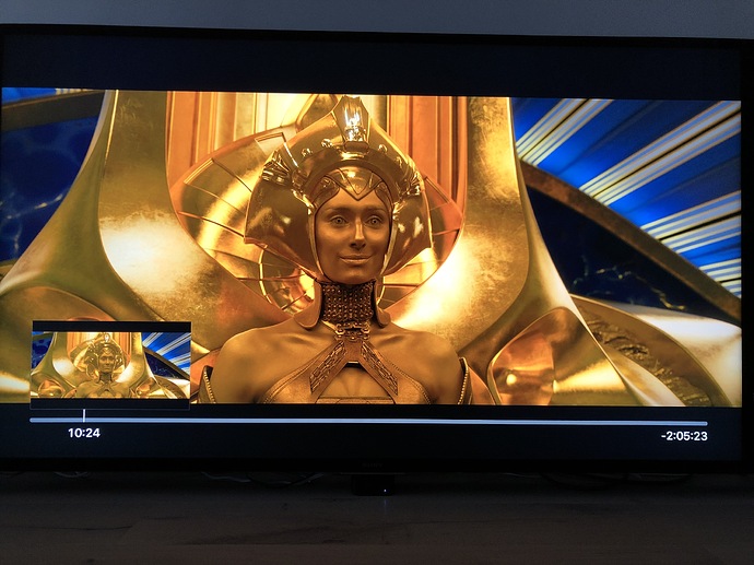

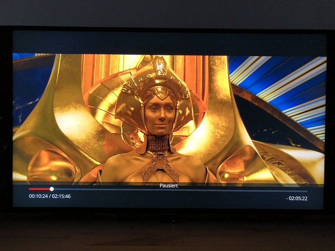

Making pictures is perhaps a good idea so I took the same as robnix for possible comparison.
Photos are made by iPhone X, TV is Sony KD75X9405C. As said before Plex & Infuse switching automatically to HDR setting, MrMC not.
description/look at the picture names:
  • Plex usage is the same as “my computer” from Apple so I used that
  • By pausing on Plex the picture gets a little bit darker through the overlay, so I made one without “Pause” too

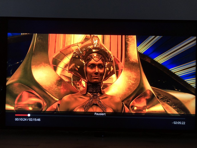

  • MrMC don’t switch on my TV so here is one with normal movie setting and one with hard switch by me to HDR setting

To me, your screenshots from Plex without pause and MrMC set to SDR setting look the same.
The Infuse screenshot clearly shows that the HDR data isn’t displayed correctly.
The MrMC with HDR setting looks very weird to me :open_mouth:
