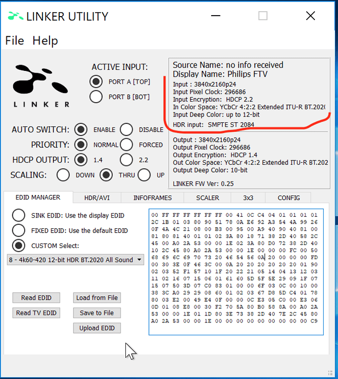

The Apple TV 4K outputs 12-bit video whenever it can for HDR10 and some TVs do not handle it well, although the video format complies with the HDMI 2.0 spec and they advertise in their EDID that they support it.
  • 2160p24 (or p25 or p30) HDR10 video is always output as 12 bit.
  • 2160p60 or p50 HDR10 is output as 12 bit if you have at least once activated 4:2:2 chroma subsampling (until you reset video settings).

Attached is the characteristics of the Apple TV’s output in 2160p24 HDR10 (there is only one chroma subsampling setting in that resolution).
