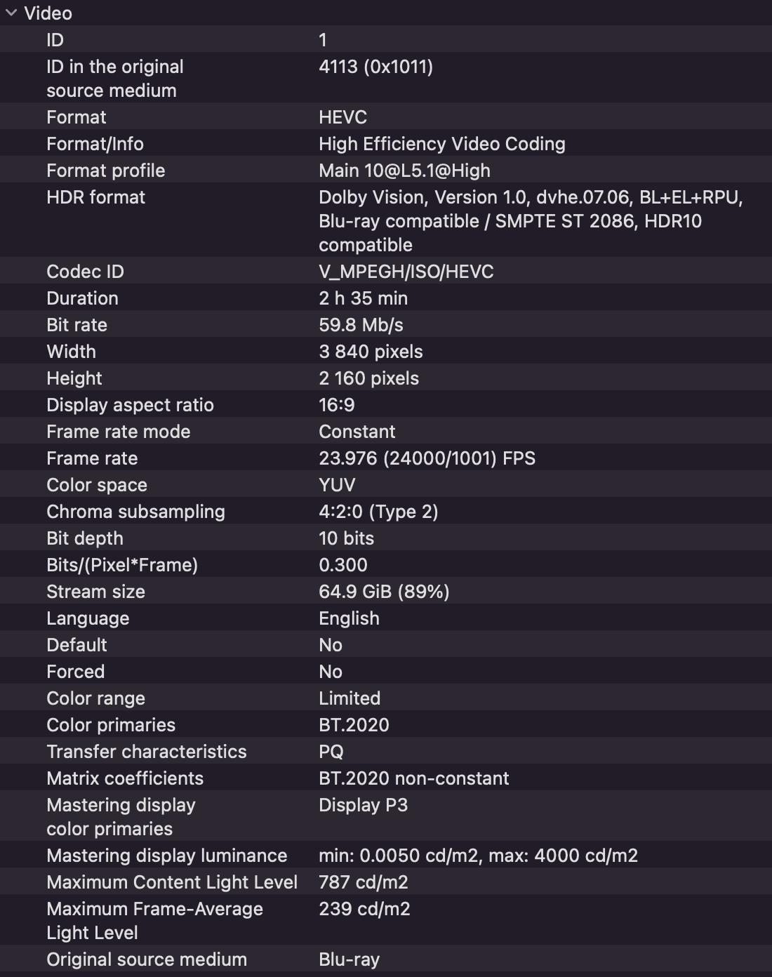

Can you run that video through mediainfo and post the results here?

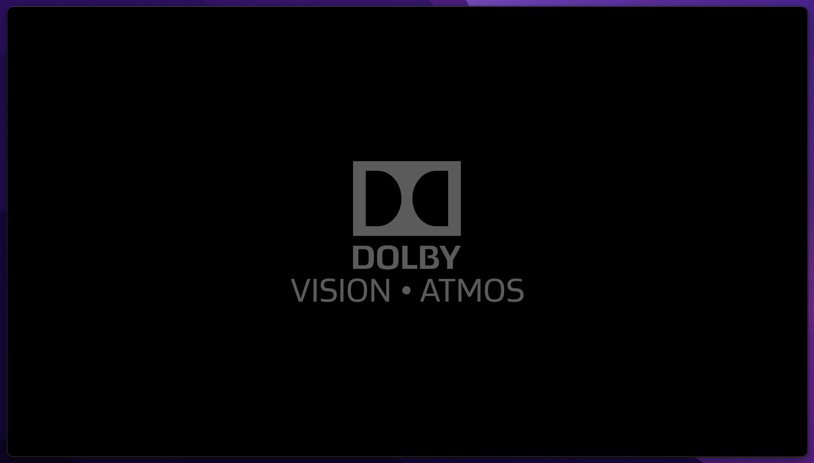

Can you please take a picture or screenshot of an HDR rendering on your Mac with infuse?
Maybe I’m too used to HDR with a lot of brightness from IINA
IINA and Infuse look identical to me for HDR. DoVi works in Infuse, but plays with incorrect colors in IINA.
In both cases, the display is clearly switching as the video window appears bright and everything else is dim (as expected).

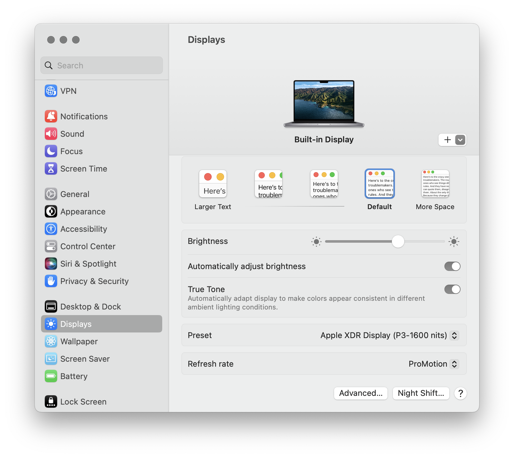

This MBP is using mostly all default settings, but here is what my display settings are currently set to.
