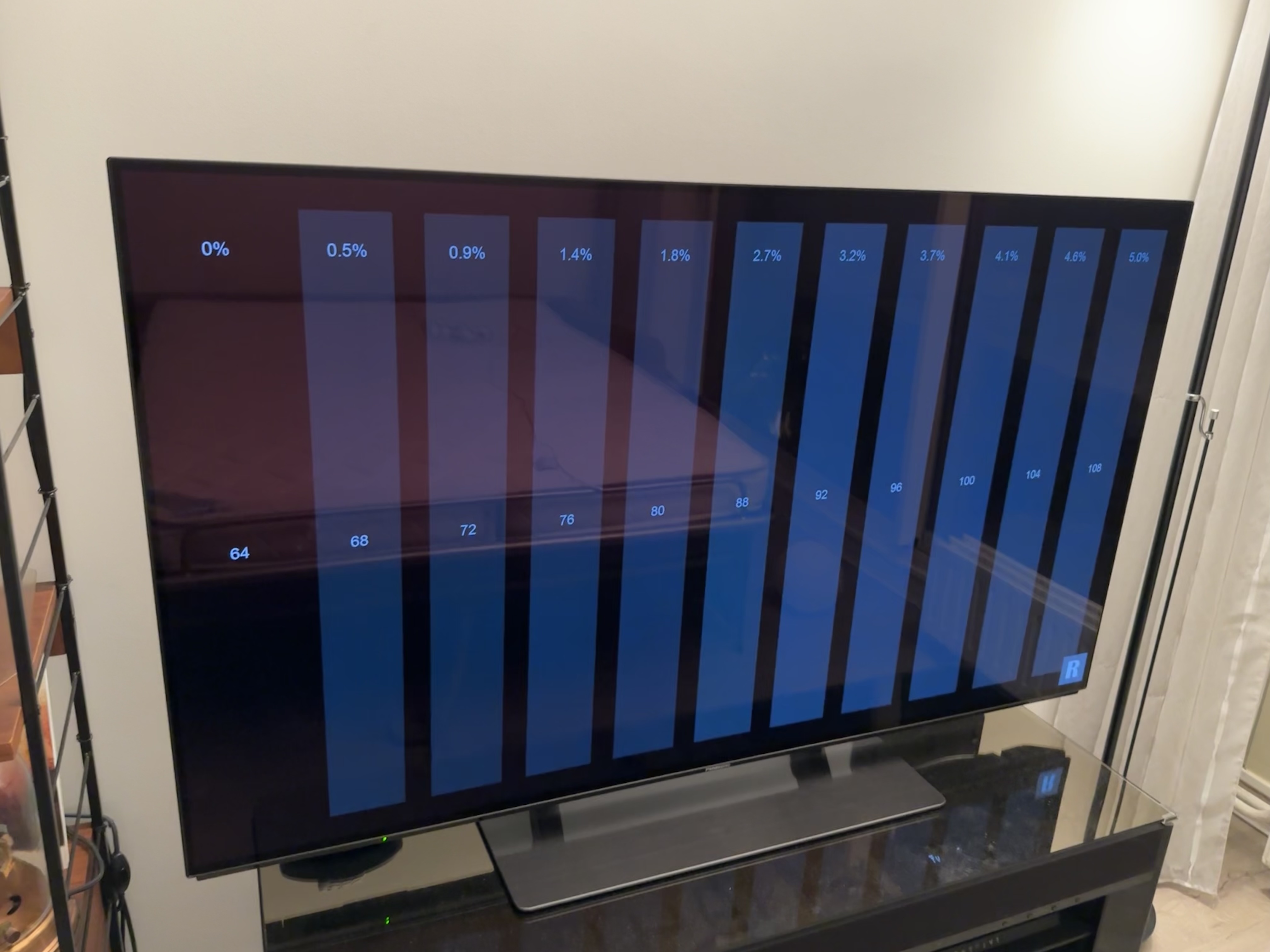

I’ve test the matrosca hdr black bars and there is some issue
With INFUSE
With VLC
Sorry for the reflect on image :sweat_smile:

Can you post a link to the greyscale file so that others can test? I downloaded a different HDR file and it seemed fine.
Hi
Here is the link to test the file
https://vinz2k.freeboxos.fr:8080/share/5AVPW_YFZPZ0umJZ/02.%20Black%20Clipping_2_HDR10.ts
With this file only the bars up to 2.7% / 88 are flashing. Should they flash till 0.5% / 68 ?
So I played your file also with MrMC app on my Apple TV and this is the same bad result.
For reference I played this Youtube Video on the internal app: Black Clipping Part 02 ~ 4K UHD HDR 10 Wide Color Gamut Calibration - YouTube
In this test I can see flashing till 68 as it should be I suppose.
So, Apple TV tvOS has a bug or your file is buggy. Unfortunately I have no other test file which I could play via Infuse. But I watched a lot of HDR content lately with Infuse and I would say it looked like it should…
