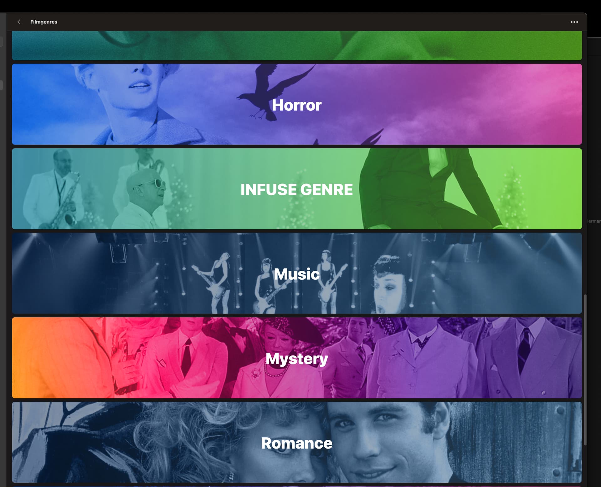

Genres are also stored in .NFO files.
If you have movie.nfo or movie name.nfo next to your movie file, infuse will read that file.
If in that file is written (as example). <genre>INFUSE GENRE</genre>
Then in infuse a genre will show up. See image.
This means, one can alter genres anyway one wants. It doesn’t matter if you choose online or local meta.
