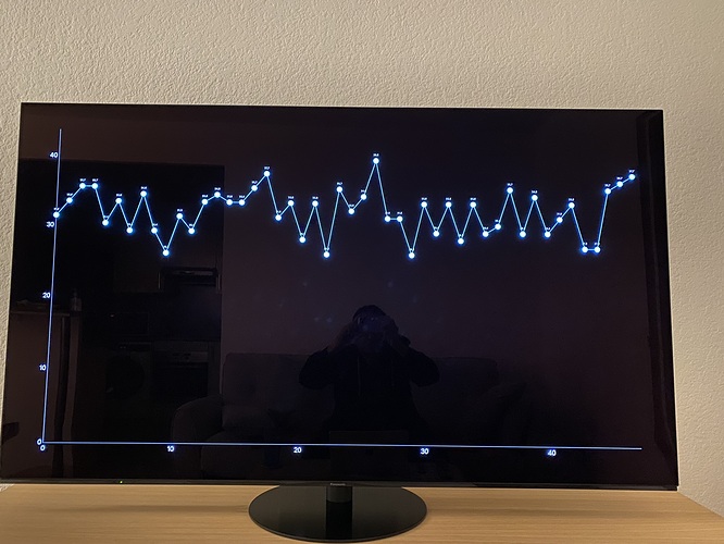

Could you provide a screen cap of the graph after a speed test in Infuse on one of these?
The video stops playing for 2/3 minutes and there is a “loading” icon.
Here is the graph:
That looks like you’re speeds are more in the 25 to 35 Mbps, not 300. What protocol are you using? SMB, FTP, etc.

Indeed, 300 Mbps is my ISP speed but I reach it often with fast.com speed test. I understand Apple TV and the data flux is different.

Your ISP speed doesn’t affect your streaming speed in Infuse unless your dealing with a cloud service.
