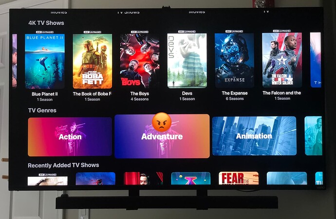

I don’t know how recently TMDB combined their “Action & Adventure”, “Sci-Fi & Fantasy”, and “War & Politics” genres … but since TMDB is the only place where Infuse pulls TV metadata from … it’s about time Infuse fixed its bug of not being able to process the ampersand in TV genres pulled from TMDB.
TMDB Bilbe: TV Genre & Keywords
There is absolutely no reason for Infuse to separately display “Action & Adventure” as both “Action” and “Adventure” — two seemingly different genres but containing identical contents. Nor should it separately display “Sci-Fi” and “Fantasy” and “Politics” and “War”.
I mean, I wish TMDB didn’t combine the pairs. While there are distict differences between action and adventure, and ever greater difference between Sci-Fi (pew! pew!) and Fantasy (abracadabra!) and Politics and War … TMDB doesn’t care … and so Infuse users are stuck combining them. Infuse pretending the categories are distinct, when they aren’t (according to TMDB), is a nasty tease and a waste of screen real estate.

For example, a show might be tagged with each of the “Drama” and “Mystery” and “Action & Adventure” genres at TMDB. That’s three points of information — not four. Infuse interprets the ampersand as the third data point actually containing two distinct pieces of information. This is incorrect. Infuse should not display separate “Action” and “Adventure” genres because there is only one genre — “Action & Adventure”. Everything viewable when you click “Action” is exactly what you see when you click “Adventure”, and vice versa.
The two buttons each present the same lists. Only one is needed. The redundant second (of each pair) is doubly bad UI — first, because both buttons do the same thing, and second, because the user is misled into thinking if they click on the “Sci-Fi” button they’ll be spared shows that are straight up fantasy, and if they click on “Fantasy” they’ll be spared shows that are hard sci-fi with no fantastical elements. But that doesn’t happen; because TMDB doesn’t make that distinction.

Three of TMDB’s approved television genres (of which there are exactly 16) contain an ampersand — they are “Action & Adventure”, “Sci-Fi & Fantasy”, and “War & Politics”.
Infuse incorrectly displays these three composite genres as if they were actually six distinct categories. There is not an “Action” genre for television (according to TMDB); nor is there an “Adventure” genre. There is only “Action & Adventure”.
Nor are there distinct “Sci-Fi”, “Fantasy”, “Politics”, or “War” genres. There is only “Sci-Fi & Fantasy” or “War & Politics”.
Please fix this. Thanks.
